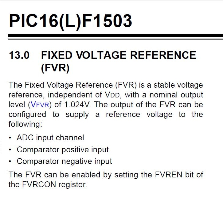

    Yes, I see that now but contradictory to this diagram, the datasheet also states that the output of the FVR can be configured to supply a reference voltage to the ADC input channel:

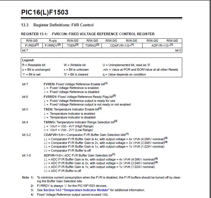

    and this is supported in the FRVCON register (bits 1-0) regarding the relevant ADC FVR buffer gain:
    Which one is to be believed?

    it could be worded better. the hight-lighted word "reference" could be removed to better reflect reality
    The Fixed Voltage Reference (FVR) is a stable voltage
    reference, independent of VDD, with a nominal output
    level (VFVR) of 1.024V. The output of the FVR can be
    following:
    • ADC input channel
    • Comparator positive input
    • Comparator negative input
    The FVR can be enabled by setting the FVREN bit of
    the FVRCON register
