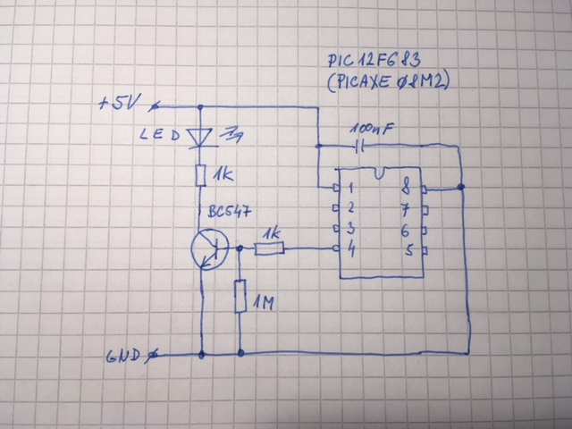

    Hello folks,
    before I tried play with picbasic I worked with PICAXE. I have done few projects with PICAXE 08M2 which is a rebranded PIC12F683 with bootloader.
    In PICAXE is one simple cheat which allows to use the pin3 (MCLRE) as output. Pin3 drives an NPN transistor via manipulating weak pullup resistor. In attachment find the schematis which I use wery often. It works fine all the time.
    For example here is a simple led blinking code in PICAXE looks like:
    #picaxe 08m2
    do
    pullup $08    ;pullup on GPIO.3 LED ON
    disable          ;disable pullups LED OFF
    loop
    Now the question is how do they made it? I try similar on PIC12F683 in picbasic but no success.
    Try to led blinking code in picbasic like:
    ;PIC12F683
    TRISIO=0
    ANSEL=0
    OPTION_REG.7=1   ;enable WPU
    strt:
    wpu=%00001000      ;enable WPU on GPIO.3
    wpu=%00000000      ;disable WPU on GPIO.3
    goto strt
    OK, I now this is not work. I also now the GPIO.3 WPU is activatable only via
    MCLRE, the GP3 pull-up is enabled when MCLRE is set to"1" in the configuration word register, and disabled when MCLRE is set to"0".
    How It works in PICAXE, thats the question. Does anyone have an idea?
    Louis

    yes, if I configure the MCLR bit in config word to "1" then the LED is ON because the transistor is open via internal pull-up. If I configute the MCLR bit to "0" then internal pull-up is disabled and the transistor is closed because the 1M resistor is pull the base to ground.
    That's work, but how to do that in program I don't know. However, it must work somehow, because in PICAXE environment it works.

    finally success. I grab one of my PICAXE 08M2, read it with pickit programmer (destroy the bootloader) and yes, it is a PIC12F1840 not a 12F683 which is a previous version of PICAXE 08M (Richard has good suggestion).
    OK, back to my question if it is possible to use the GP3 (MCLR) pin as digital output on this 12F1840 yes, it is!
    This method is suitable to switch simple devices like relays, LEDs, etc. The state is only 1 or 0 (on/off).
    All done with enabling or disabling the GP3 pin internal pull-up resistor. The circuit is the same as in my previous post, and the example code for PIC12F1840 LED blinking on GP3 is like:
    ;PIC 12F1840
      __config _CONFIG1, _FOSC_INTOSC & _WDTE_OFF & _PWRTE_ON & _MCLRE_OFF & _CP_OFF & _CPD_OFF & _BOREN_ON & _CLKOUTEN_OFF & _IESO_ON & _FCMEN_ON
      __config _CONFIG2, _WRT_OFF & _PLLEN_ON & _STVREN_ON & _BORV_19 & _LVP_OFF
    DEFINE OSC 32    ; Use internal clock
    OSCCON = %01110000
    CLKRCON = 0
    TRISA = %000000
    ANSELA = 0
    OPTION_REG.7=0  ; Enable internal pull-ups
    strt:
    wpua=%001000
    PAUSE 500
    wpua=%000000
    PAUSE 500
    goto strt
    The LED is on when pull-up is set ON, and the LED is OFF when the pull-up is set to OFF, that simple it is.
    I think, this method is usable for all PIC devices which allows to individual pull-up switching on MCLR pin.
