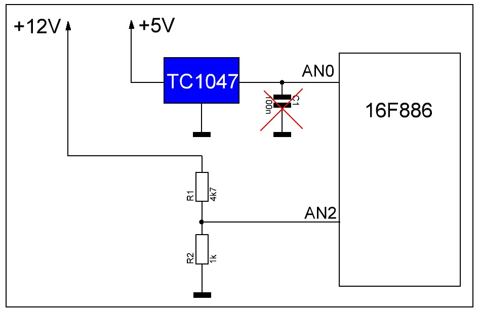

    Thank you Ioannis for your effort ! .. you spend a time for me. The problem is solved, I don't understand what happened really.
    So, on AN0 I had a TC1047 ( analog temperature sensor ) with a 100nF capacitor to ground. The voltage measured on AN0 was 726 mV , also I verified with a osciloscop and I had a "clean" voltage. After I removed the capacitor, AN0 work well .

    Default Re: help setting up 16F886 for ADC
    this may lead you to these two things:
    1. Your cap is shorted, or
    2. if you use breadboard, it is faulty.

    I work on proffesional PCB, I changed the capacitor, but the same problem. So, nevermind, without 100nF capacitance the AN0 is ok. Anyway is strange whats what happen there.
    On AN0 I read the voltage from a linear sensor temperature (TC1047). The temperature slope is fixed at 10 mV/°C and the output voltage at 0°C is 500 mV (according with page4 from datasheet).
    My ideea to extract the °C isn't ok because the maximum reading read on the input is 1024 ((1024-500) / 10 = 52.4 degrees) and the number of read bits is read in step 5, so only 256 bits.
    The problem with me is that I do not read correctly the milivolts on 10 bit. Any ideea is apreciated, thank you !
