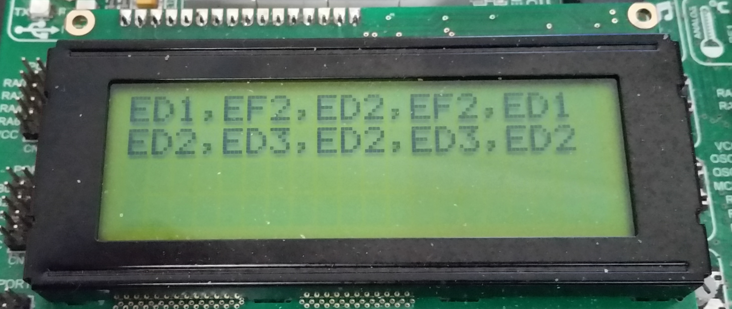

    I assume a input constructed like this,
    ie 15 binary values in this order ,
    arraywrite inbuff ,[$ED,$1E,$D2,$EF,$2E,$D3,$ED,$2E,$D2,$EF,$2E,$D3,$E D,$1E,$D2]
    this does work
      Pause 500       ' LCD initialize time
        lcdout $FE,1
        inbuff var byte[15]
        dataword var word[10]
        d var byte
        INPOINTER VAR BYTE
        outpointer var byte
        arraywrite inbuff ,[$ED,$1E,$D2,$EF,$2E,$D3,$ED,$2E,$D2,$EF,$2E,$D3,$ED,$1E,$D2]
        for d=0 to 4
        dataword[d*2]=inbuff[d*3]*16+inbuff[d*3+1]>>4
        dataword[d*2+1]=inbuff[d*3+2]+(inbuff[d*3+1]&$f)*256
        next
        for d=0 to 4
        IF D=4 THEN
        lcdout $FE,$80+d*4,hex3 dataword[d*2]
        lcdout $FE,$c0+d*4,hex3 dataword[d*2+1]
        lcdout $FE,$80+d*4,hex3 dataword[d*2],","
        lcdout $FE,$c0+d*4,hex3 dataword[d*2+1],","
        next
