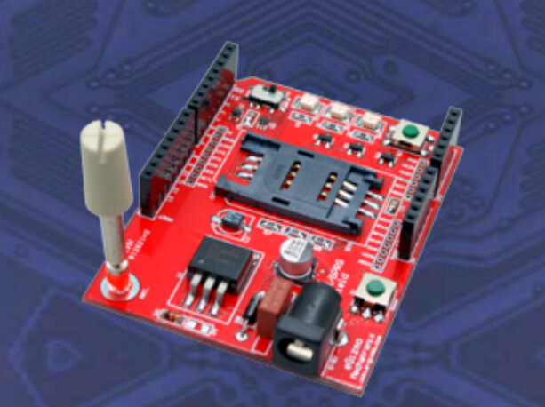

    The image that is shown below is the GSM Shield SIM900D that I used for my project. You can purchase this at http://www.e-gizmo.com/KIT/gsm shield.html for about 1,995.00 pesos.

    Features and Specifications of GSM/GPRS Shield:
    • Industry proven SIMCOM SIM900D Module
    • Buffered UART provides additional layer of protection
    • Fused power input
    • On board LDO voltage regulator
    • UART/SUART switch selectable port (gizDuino)
    • On board manual power switch
    • SIM Card Holder
