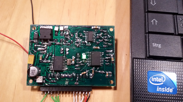

    Made several mistakes, killed one 18F1320 donīt know how , destroyed my PICKIT operating system, had to desolder and solder one 18F1320, BIG Mistake in the schematic: I had to use the lower 4 bits of PORTA and these begin at PORTA0 not PORTA1 . Put a resistor between 74HC14 and RB1 otherwise the PIC may be grilled.
    Changed config:
    CONFIG OSC = HS ;Clock out on RA6 :1/1 CLKI
    now the second PIC gets the same frequency out of the first PIC. Checked it with a scope.
    Hardware seems to work (if nothing else is grilled) and I can jump into software.Name:  TESTBOARD1.png
