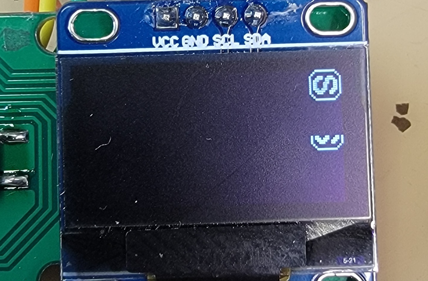

    Richard, I am hoping you can help me with an issue I am having making your SSD1306 driver work. Everything is working well except when I display a bitmap with the y axis not set at 0 it cuts the image in half. I have tried with every version of the ssd1306_I2C.INC found in this thread with the same result. Posted here is the code with a simple 16x16 bitmap icon and an image of it displayed at both y=0 and y=4. Any chance you can help sort what is going on here?

        SSDBM 112,0,16,16 ,StallIcon ;x,y,w,h,label   Y=0 (DISPLAYS OK)
    '    pause 100
    '    SSDBM 112,0,16,16 ,BlankIcon ;x,y,w,h,label
    '    SSDBM 112,2,16,16 ,StallIcon ;x,y,w,h,label   Y>0 (DISPLAYS HALF OF IMAGE)
    '    pause 100
    '    SSDBM 112,2,16,16 ,BlankIcon ;x,y,w,h,label
        SSDBM 112,4,16,16 ,StallIcon ;x,y,w,h,label   Y>0 (DISPLAYS HALF OF IMAGE)
    '    SSDBM 112,4,16,16 ,BlankIcon ;x,y,w,h,label
    '    SSDBM 112,6,16,16 ,StallIcon ;x,y,w,h,label   Y>0 (DISPLAYS HALF OF IMAGE)
    '    pause 100
    '    SSDBM 112,6,16,16 ,BlankIcon ;x,y,w,h,label
    yep, i never did test with other than 64x64 bmps, that masked the fault
    now we know it works with 64x64 and 16x16 bmps at least
    there is a defect in the include file, the bmp usercommand macro is not quite right
    in the include file the bit in red needs to be added in

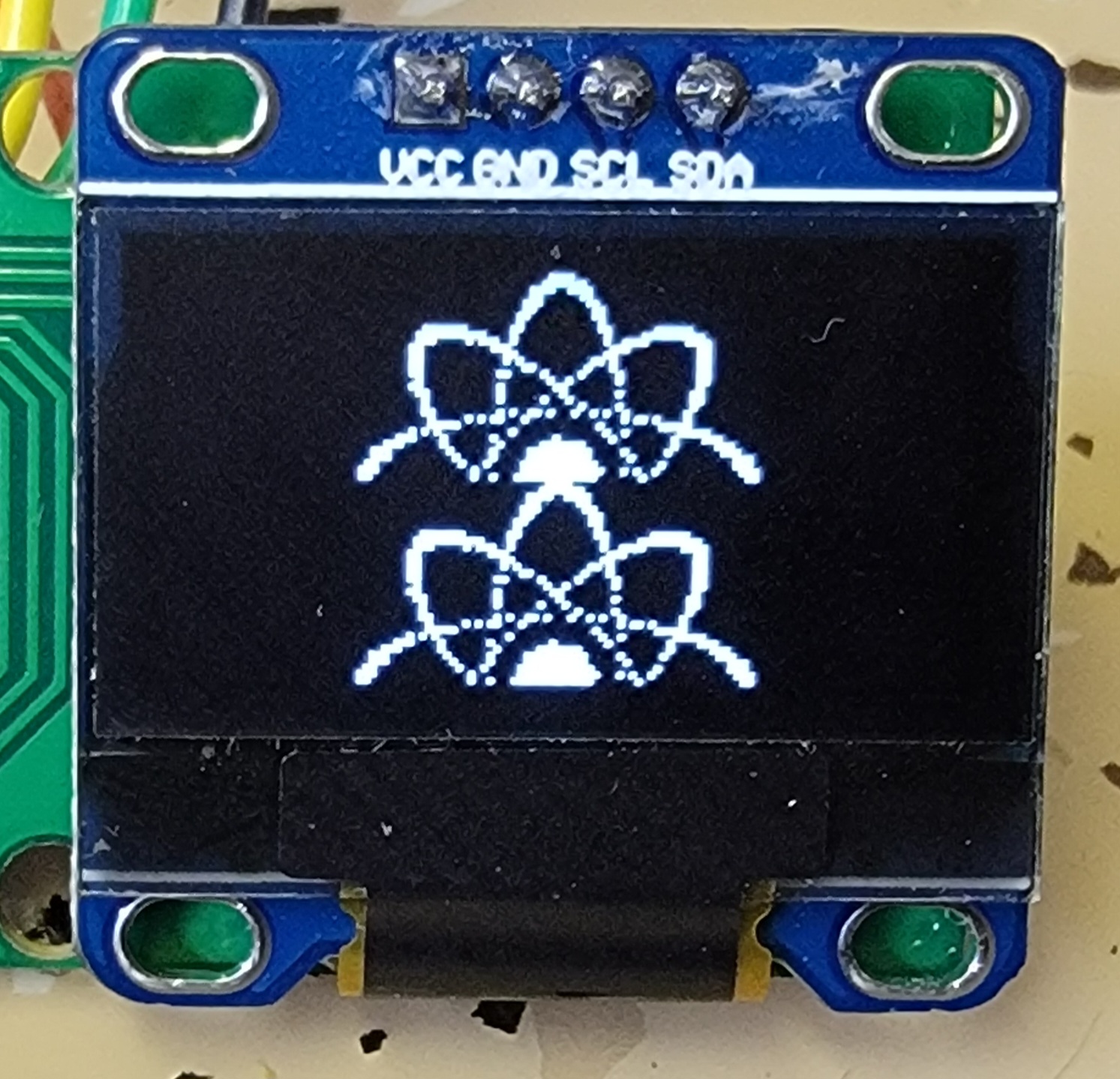

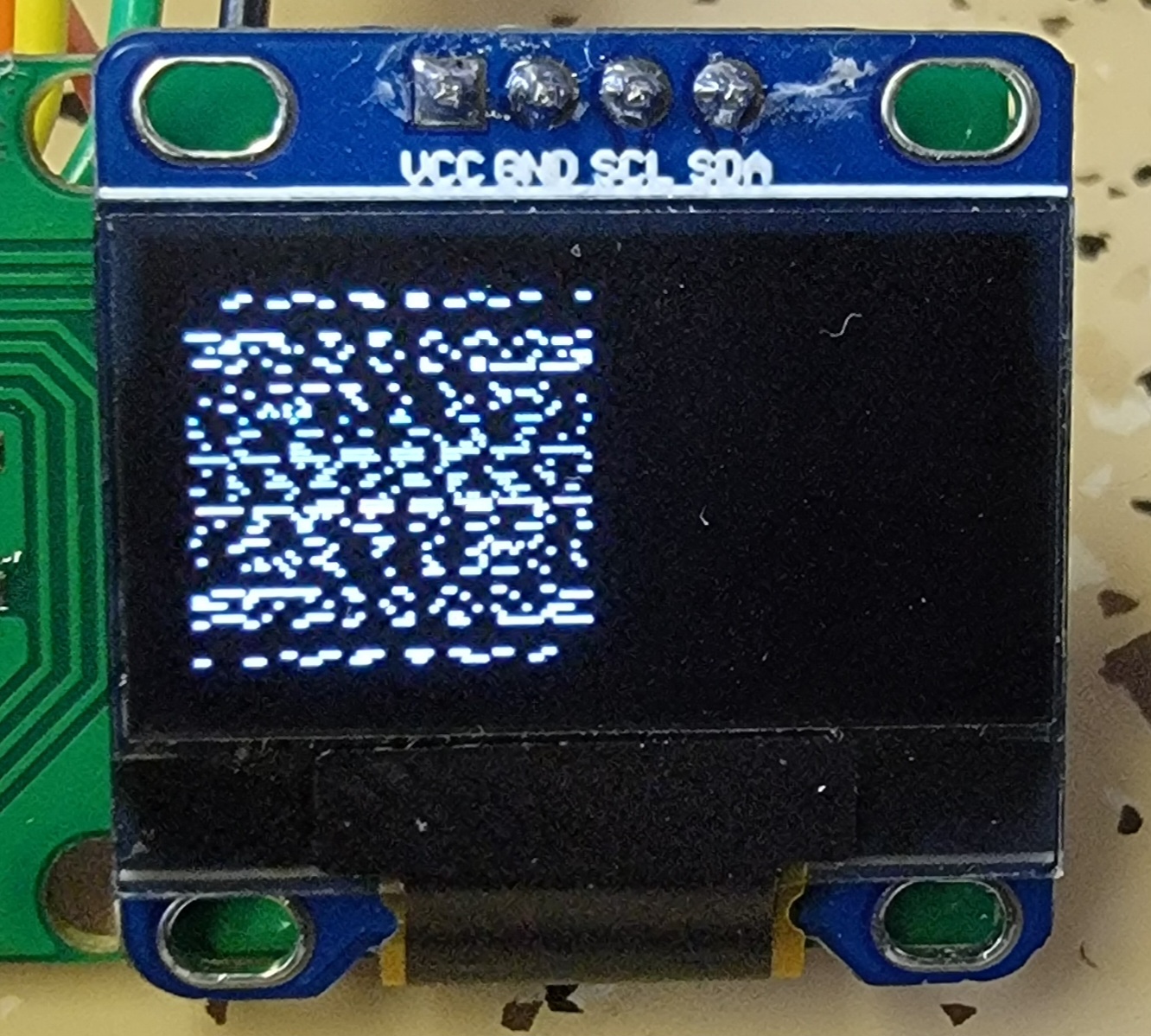

    When I use SSDBM it shows the top half of the image twice, and seems to lock the display as I can't clear or alter what is displayed afterwards.
    Using the DMDBMP format, it displays a black screen, but if I attempt to display something afterwards it goes nuts. I assume I'm not addressing the BMP data location correctly, but don't see an example or instructions on using a bitmap.
    DMDBMP 0,0,logo64  'X,Y,LABEL      (HOW DO I SPECIFY SIZE???)
    gosub show
    Here is the code I am running right now with the bmp. Doing it this way seems to get stuck right after the image is displayed, and it looks like the picture below.

    SSDBM 31,0,64,64 ,logo64        'This displays the top half of the image ok, and repeats the top half on lower half of screen

  12. #92
    2,722
    Default Re: SSD1306 INCLUDE for PBP3
    there is no need to modify the include
    the correct usage is
    DMDBMP 0,0,logo64
    bmp's need a header to set width and height
    logo64:             '64x64 image
    @ db   64,64 //  header width,height
    @ db   0, 0, 0, 0, 0, 0, 0, 0, 0, 0, 0, 0, 0, 0, 0, 0
    @ db   0, 0, 0, 0, 0, 0, 0, 0, 0, 192, 112, 60, 28, 6, 7, 3
    @ db   3, 7, 6, 14, 28, 112, 224, 0, 0, 0, 0, 0, 0, 0, 0, 0
    @ db   0, 0, 0, 0, 0, 0, 0, 0, 248, 254, 7, 7, 3, 3, 3, 3
    @ db   3, 6, 2, 6, 4, 12, 136, 184, 23, 33, 64, 64, 0, 128, 0, 0
    @ db   0, 0, 0, 128, 64, 32, 33, 23, 120, 136, 12, 4, 4, 6, 2, 3
    @ db   3, 3, 3, 3, 7, 6, 254, 252, 0, 0, 0, 0, 0, 0, 0, 0
    @ db   0, 0, 0, 0, 0, 0, 0, 0, 2, 7, 60, 224, 128, 128, 128, 128
    @ db   0, 64, 0, 64, 0, 64, 110, 0, 32, 0, 64, 32, 32, 8, 33, 2
    @ db   6, 9, 32, 16, 0, 32, 128, 32, 0, 21, 96, 0, 64, 64, 0, 64
    @ db   128, 128, 128, 128, 224, 28, 15, 1, 0, 0, 0, 0, 0, 0, 0, 0
    @ db   192, 224, 120, 24, 28, 4, 6, 2, 3, 0, 1, 0, 1, 6, 8, 16
    @ db   32, 0, 192, 0, 32, 154, 4, 0, 1, 128, 224, 248, 248, 252, 252, 254
    @ db   252, 252, 252, 252, 248, 224, 64, 1, 2, 0, 73, 16, 64, 128, 0, 64
    @ db   32, 8, 6, 1, 1, 1, 1, 3, 2, 6, 12, 12, 56, 112, 240, 192
    @ db   3, 15, 30, 24, 60, 96, 96, 64, 192, 128, 128, 128, 128, 64, 60, 12
    @ db   2, 1, 0, 2, 0, 0x2C, 144, 0, 0, 0, 15, 31, 31, 63, 127, 63
    @ db   127, 63, 63, 31, 31, 15, 1, 128, 0, 32, 0x94, 8, 2, 0, 1, 2
    @ db   8, 16, 96, 128, 0, 128, 128, 64, 64, 96, 96, 60, 24, 14, 15, 3
    @ db   0, 0, 0, 0, 0, 0, 0, 0, 128, 240, 56, 7, 1, 1, 1, 0
    @ db   3, 0, 2, 2, 4, 2, 234, 4, 0, 1, 4, 4, 0, 12, 144, 64
    @ db   64, 36, 152, 0, 4, 2, 0, 4, 0, 178, 6, 0, 2, 2, 2, 2
    @ db   0, 1, 1, 1, 7, 28, 240, 128, 0, 0, 0, 0, 0, 0, 0, 0
    @ db   0, 0, 0, 0, 0, 0, 0, 0, 31, 127, 240, 192, 192, 192, 192, 192
    @ db   192, 192, 32, 96, 32, 16, 16, 31, 248, 132, 4, 2, 1, 0, 0, 0
    @ db   0, 0, 0, 1, 2, 4, 132, 120, 31, 16, 60, 32, 32, 96, 64, 192
    @ db   192, 192, 192, 192, 224, 112, 127, 63, 0, 0, 0, 0, 0, 0, 0, 0
    @ db   0, 0, 0, 0, 0, 0, 0, 0, 0, 3, 14, 60, 60, 112, 224, 192
    @ db   192, 224, 112, 112, 24, 30, 3, 0, 0, 0, 0, 0, 0, 0, 0, 0
  13. #93
    Apr 2007
    Pennsylvania, USA
    158
    That gets me closer, in the sense I figured it needed specified somewhere! But it doesn't correctly display the image. I have reverted back to non-edited include files. Thoughts? Thank you for your assistance!!!
    Shawn

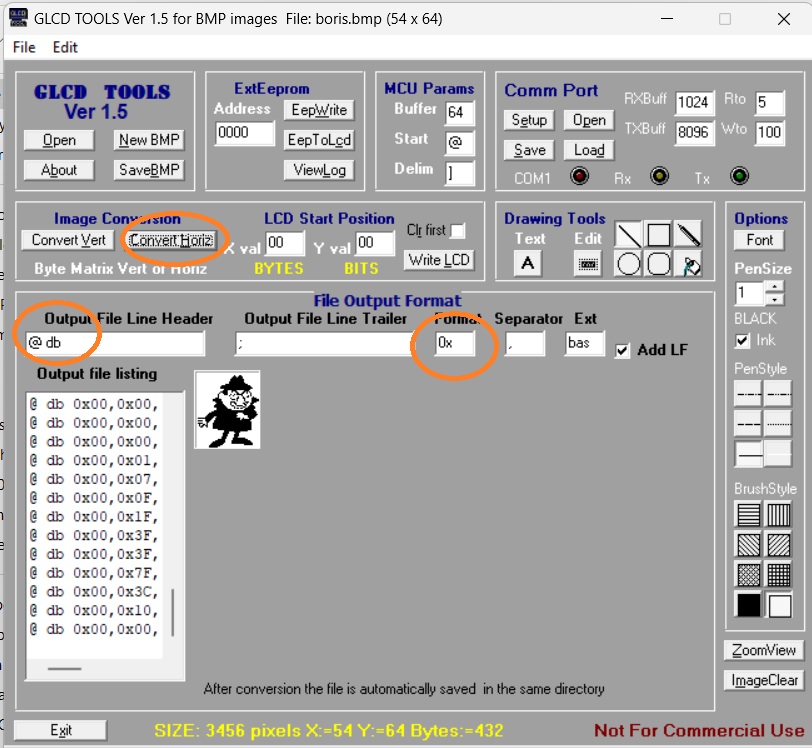

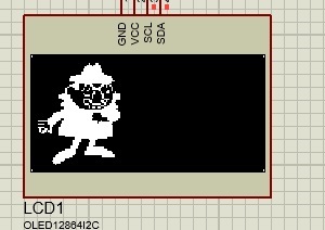

    ah! the bmps are in a different format the byte are now laid out horizontally
    i also discovered the dmp code upsets the font height [did have a shared variable]
    i used lcdassistant to generate bmps
    some files to play with
  15. #95
    2,722
    glcd tools also works well in generating bmp's
    and formats the data nicely
  16. #96
    Apr 2007
    Pennsylvania, USA
    158
    The only version of GLCD Tools I can find is 0.2. I have been using LCD Assistant, but I'm having mixed results. Do you have a link to download GLCD Tools 1.5?
    This attached file has a few BMP's in it, the Logo64 opens successfully, except it takes 5+ seconds to display each image after the screen clear... The other 2 (StallIcon and OneIcon) both don't load and results in a bricked display until power cycle. I have tried other's and can't get them to open.
    These were created with LCD Assistant set to horizontal and formatted appropriately.
    I'm not sure the reason for the failed images to display,
    I'm not sure the reason for the really slow load times to display the images
    The SSD1306 driver this thread was created for loads images with excellent performance.
    Shawn
    I resolved the slow load times by commenting out the debug lines in the sbmp subroutine.
    Shawn
  18. #98
    Apr 2007
    Pennsylvania, USA
    158
    I have found if I revise the first byte of the bitmap to = 0x00 instead of the value it should be, the image will display. Obviously missing the first 8 pixels worth of data though...
    Shawn
  19. #99
