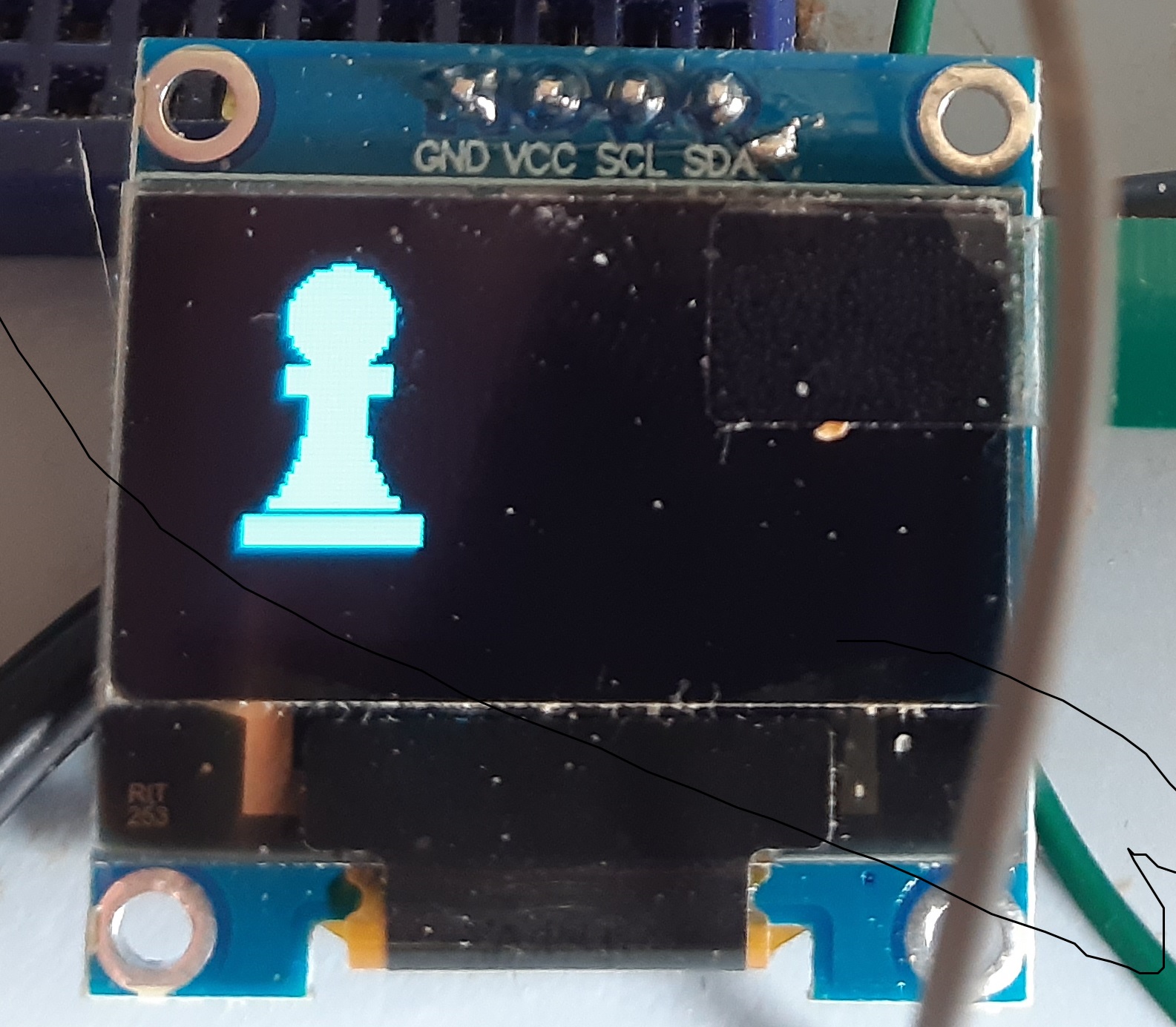

    i use MikroElektronika GLCD Font Creator
    here is example pawns as 16x16 font [variable width C code output new type ]
    chars A,B,C,D have been mapped to black pawn on black square , black pawn on white square
    and white pawn on black square , white pawn on white square
    PAWNS.BAS

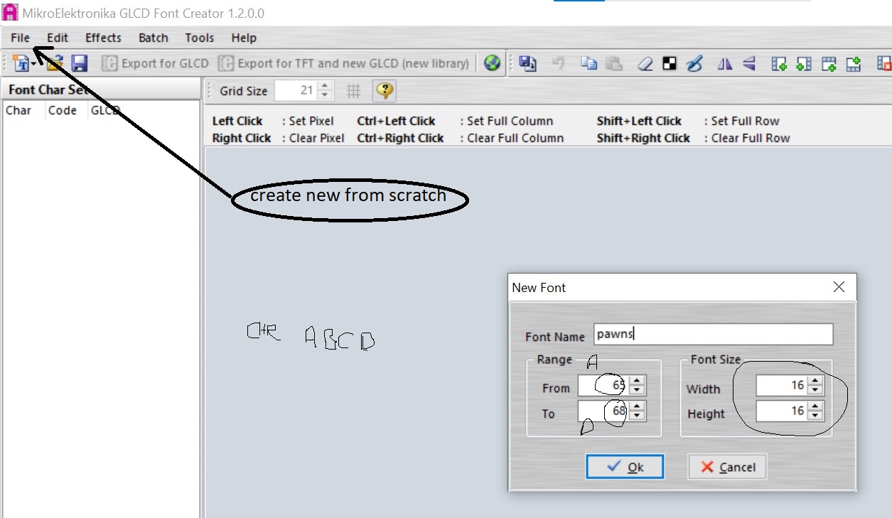

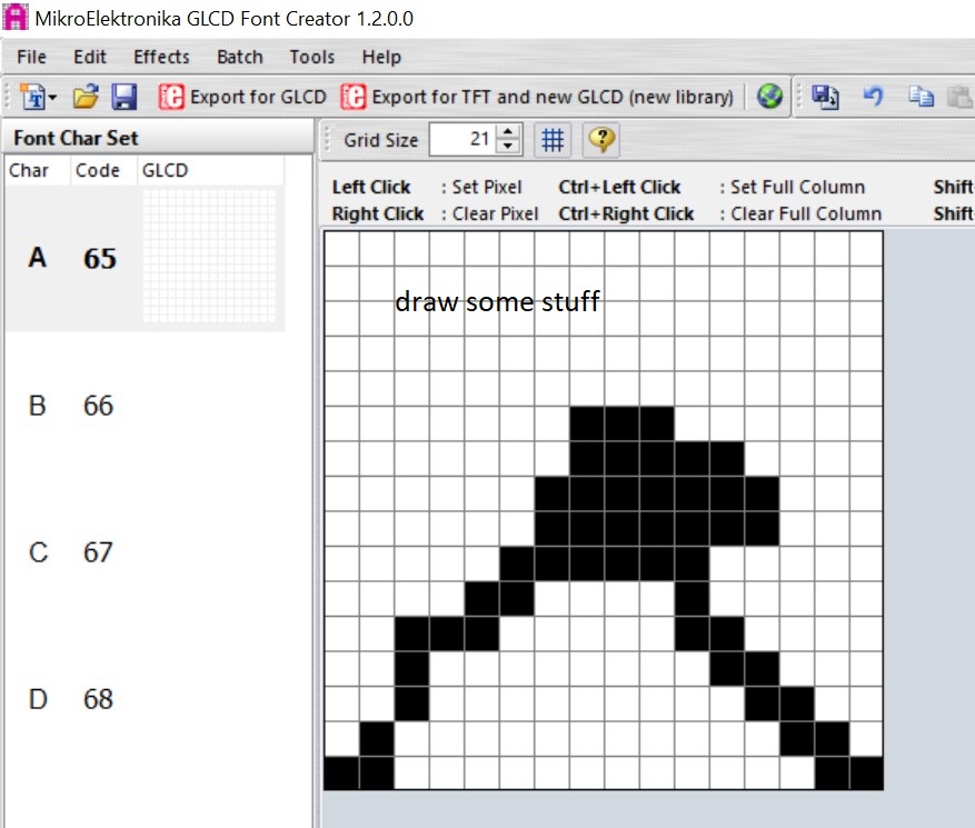

    step 1 create a font

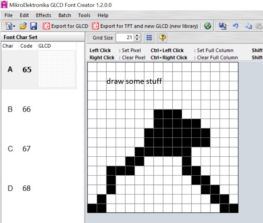

    step 2 edit it to taste

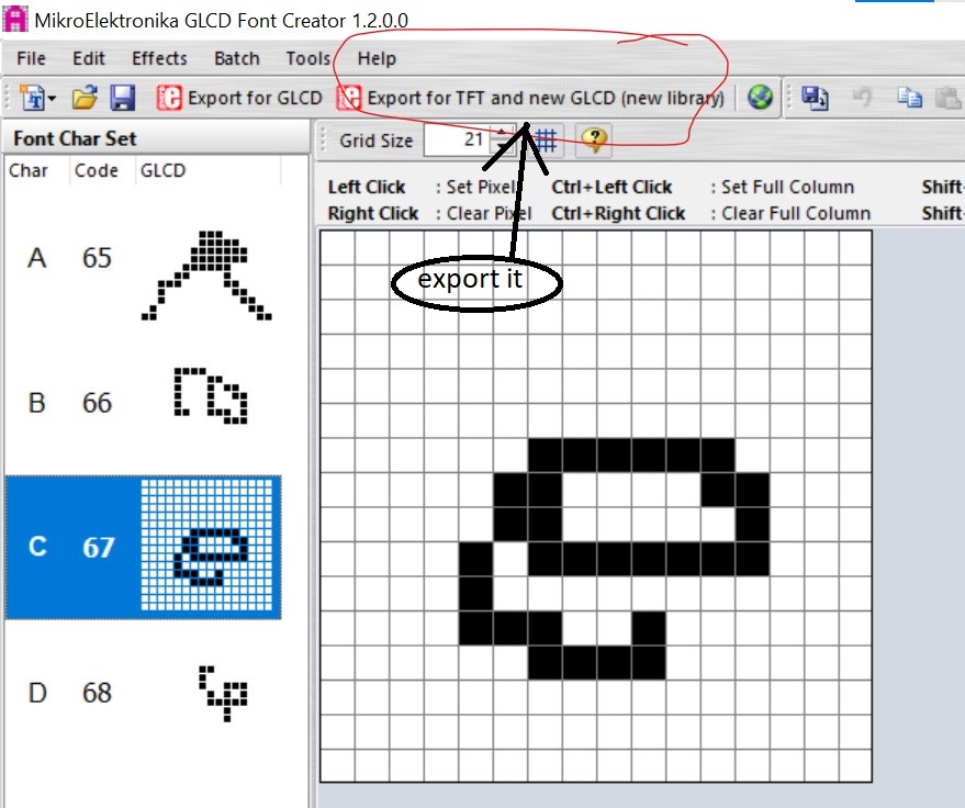

    step 3 create blank include file
    and export

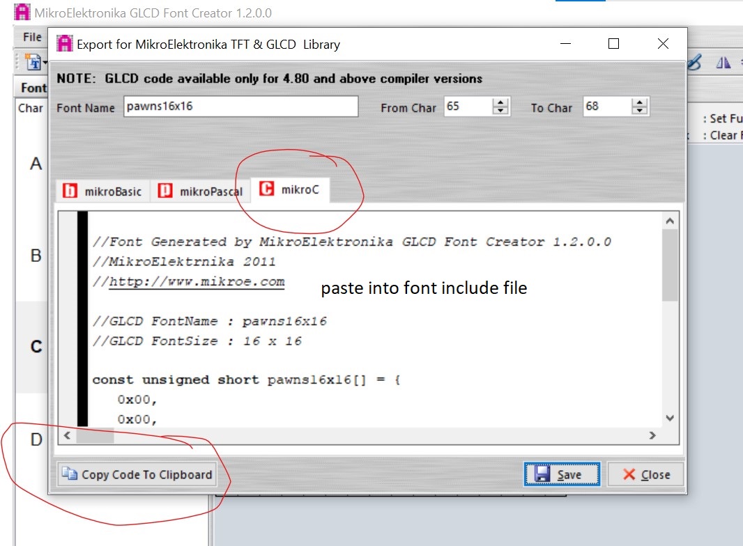

    step 4 paste export in suitable format into include
    do some editing to get it to pbp format
    remembering never allow a odd number of bytes on a line
    never change order or number of data bytes to encode

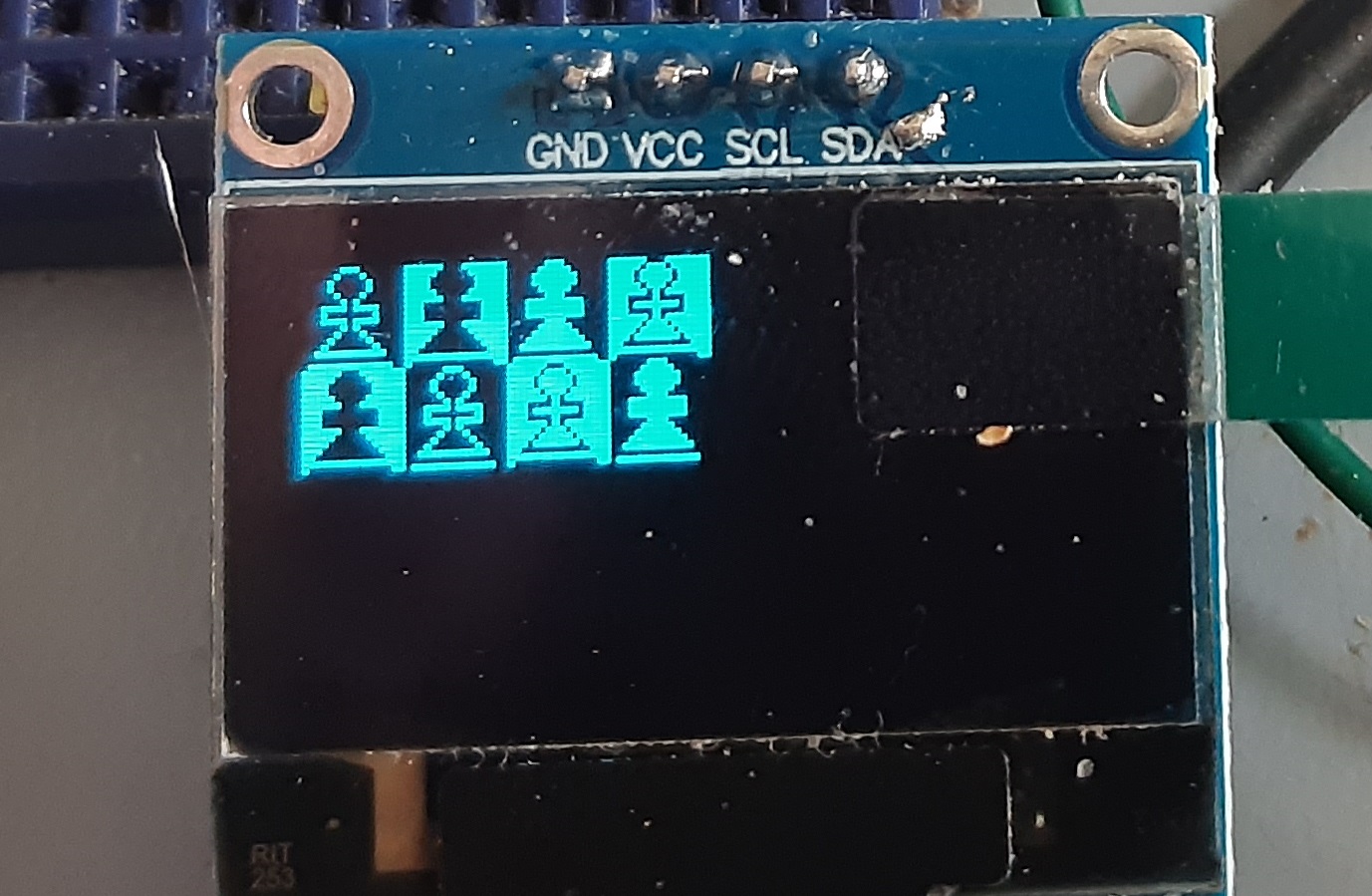

    ps , for a chess board all chrs need to be same size , the font creator will optimize the shit out of your creations it hates blank columns on either edge
    its a battle of wits .
    this ver may make fonts easier to but up to each other

    Next, how to import the 16x16 characters into the 5x7 library.
    you cannot , the font is 5x7 hard coded
    Can these co-exist?
    not as a font
    I tried to add your pawn example after the 5x7 data but obviously this does not work if one wants to print character 128...
    i see no impediment to 5x7 chrs being added to the font to a byte sized quantity, the upper font boundary is not enforced
    mixed font heights is not implemented
    I attach my failed try.
    if you want 16x16 fonts see here, its a completely different strategy
    http://www.picbasic.co.uk/forum/showthread.php?t=24218
    if you want to persist with this code, the chess pieces will need to be bitmaps
    bitmaps in an array would be fairly straight forward, two for each piece type , one as solid the other an outline, with a blank w and blk too
    the board could also be a bit map a piece could then be or-ed or exor-ed into a square depending piece colour and square colour
