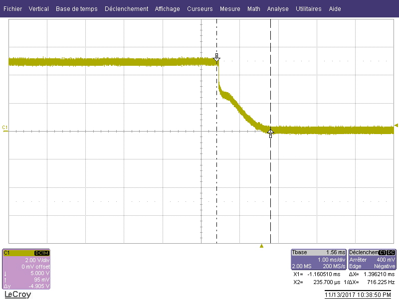

    With my DSO, I can see something strange. It takes more than 1mSec to become low (see curve)
    This is only on PORTB.2 !

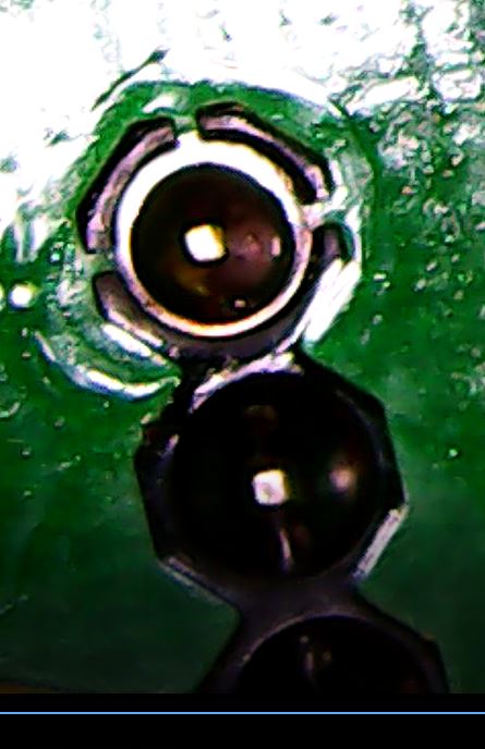

    I just found the problem... It's an hardware problem. Can't see it without binoculars... soldering to ground on PCB was not good
    Thank you.
