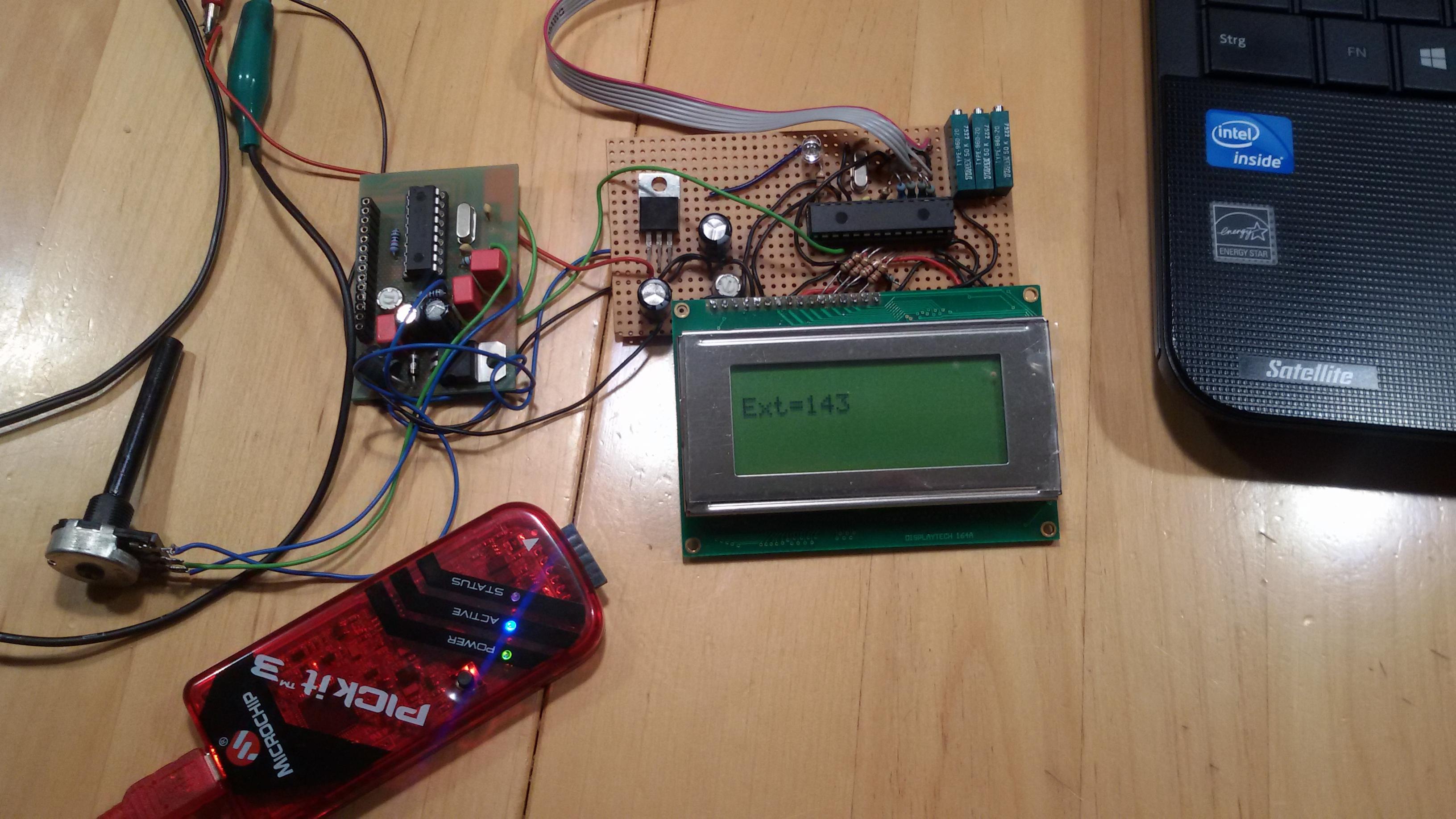

    Trying to send one byte from a PIC16F876A to a PIC16F88 and display it.
    Tried Debug,Serin and donīt get it working.
    Everything works in the proram exept the serout - serin communication.Tried with pullup resistor, baud rates from 1200 to 9600, negative and true.....tried to get samples from this forum, tried samples out of several PIC programming books, I donīt get it.
    Hello World2serin.txtADCINBargraphserout.txtHello World2serin.txt
    Jan 2008
    Selm, Germany
    116
    Default Re: PIC18F1320 HPWM on 2 pins
    Hello folks,
    please help because Iīm totally stuck.
    Try to send one byte from a 16F88 to a 16F876A and display it on LCD using DEBUG.
    16F88 measures voltage on one pin and send the variable adval to 16F876A.
    Problem is: the LCD at the 16F876A shows only 4 different charcters: 48 up to 51 or if I change from DEC3 to DEC1 0 to 3.
    Should be 0 to 255 . The Voltage at the analog Input goes the full way from 0V to 4.8V but the LCD shows only 4 different characters which change at about 1/4 of the voltage change, so its proportional to the voltage change .
    I get the message "some configuration words are not in hex" from my PICKIT2 but only when programming the 16F88.

    2,721
    Define ADC_BITS 4 ' Set number of bits in result
    from manual
    You may set ADC_BITS to values 8-16, but in reality the result will either be 8-bits or the maximum precision available (10-bits, in most cases).
    DEBUG #adval
    could send 1 to 5 ascii chrs for a word value {adc value 1 to 4 chrs }
    DEBUGIN 1000,timeout,[adval]
    how is that meant to work ? you will also discover debug sends/receives bytes not words
    DEBUGIN 1000,timeout,[dec adval]
    might have a chance.
    simplistic async coms like this is seldom reliable, especially if the receiver has other tasks to perform other
    than sitting there waiting for a transmission.
    packetizing data in stx/etx codes and preferably with crc too is a better choice

    2,721
    DEFINE DEBUG_Mode 0
    IS INCORRECT and simply won't do anything
    pbp defines must be uppercase
    try it this way tx:-
    DEFINE DEBUG_MODE 0
    DEFINE DEBUG_BAUD 9600
    DEBUG "*.*",DEC5 GLCDBM ,13,10
    rx
    SERIN2 PORTC.7,84,[ WAIT("*.*") , DEC RX] ;
    if this is still your goal
    So I guess its waaaay easier to use two
    PICs than to scramble everything in just one
    then you are sadly misguided , its never easier . get a better chip that's way easier
    if your goal is different why not start a more relevant thread
    either way post your latest code

    Hello Folks,
    so at least I got it working. No loud laughs please, I'm too old to stand it.
    Code is like this:
    TX
    '* Name : 16F88debug1 *
    '* Author : MUGELPOWER/2 *
    '* Notice : Copyright (c) 2017 [select VIEW...EDITOR OPTIONS] *
    '* : All Rights Reserved *
    '* Date : 08.12.2017 *
    '* Version : 1.0 *
    '* Notes : WORKS! *
    Define OSC 4
    Define ADC_BITS 8 ' Set number of bits in result
    Define ADC_SAMPLEUS 50 ' Set sampling time in uSec
    DEFINE DEBUG_REG PORTB
    DEFINE DEBUG_BIT 2
    DEFINE DEBUG_BAUD 2400
    DEFINE DEBUG_MODE 0
    DEFINE DEBUG_PACING 1000
    TRISA = %11111111 ' Set PORTA to all input
    ADCON1 = %00000010 ' Set PORTA analog
    CMCON = 7 ' Disable analog comparator
    ANSEL = %01000000 ' set AN6 (RB7) as analog, others to digital
    RX VAR WORD
    PAUSE 1000 ' lcd settle time
    DEBUG 10,13
    ADCIN 6,RX ' Read channel 6 (RB7)
    DEBUG "*.*",DEC3 RX ,13,10 ' dec3 is important
    Goto Main

    Two main problems before:
    1. yes Scampy youre right: Main not Loop
    2. ADCON1.7 = 1 had to be erased, after that the reciever shows 0 to 255 and not 0 to 3.
    Thanks for your help.

    Wink Re: PIC18F1320 HPWM on 2 pins
    Hello Acetronics2,
    now I guess I know how to post pictures.
