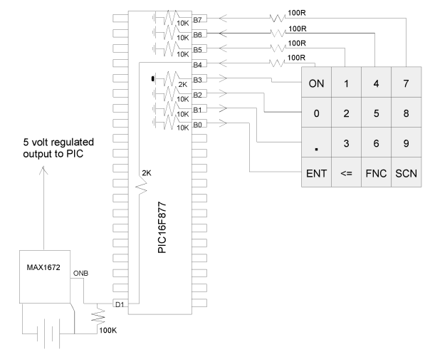

    I am designing a project to switch my circuit on with a membrane keypad using a MAX1672 (see attached drawing) with a PIC16F877 @ 20MHz.
    The ONB Pin on the MAX1672, is by default HIGH, to keep the circuit off, if I press the ON button on my keypad it should switch it ON and then in my code I would put PORTD.1 LOW to keep it on, but this does not work.
    When I press the ON button it switch the circuit on, but when I release the button it switch it off again, so my PORTD.1 is not kept LOW.

    Hi koossa.
    That guy's explaination doesn't make much sense. If you're holding the ON button, the pin is being held low. &nbsp;How is the Pull-Up resistor going to cause a problem with R-M-W. The Pin will be set low in the program long before the button is released.
    How are you setting the output?
    LOW PORTD.1
    -or-
    PORTD.1 = 0
    If it's the second one. Are you also setting the appropriate TRIS bit?
    TRISD.1 = 0 ' Set PORTD.1 to output
    -or-
    OUTPUT PORTD.1
    <br>
    oops, caught you in the middle of posting. I'll take abother look.
    I'm using LOW PORTD.1
    After power up, the pin gets set low, and then immidiately it starts scanning the keypad. With your finger still on the button, you now have a dead short from the 5v being output on PORTB to the 0v being output on PORTD.1.
    This will probably cause the MAX1672 to shut-down. Or to oscillate between on and off untill you release the button.

    Default You cannot use the same pin for keyboard scanning.
    Hi there,
    You cannot use the pin (portd.1) for any other purpose like a keyboard scanning routine (which you r doing as far as your schematic goes ).
    Please take note of the following. Why don't you use the ONA pin on the MAX1672.That is positive edge triggered. By default when a PIC wakes up the pin in an input (tristated). Do the following
    1. Turn of the AD and make the pin digital (if it has a muxed analogue in)
    2. Set the DATA direction register
    3. Throw the value to the port
    This will set your circuit kicking till you make the pin high and kill the power supply.
    A detailed schematic and complete code would be appreciated.

    Attached is my circuit, and my picbasic code not working and the one who is working?

    The design I looked at is this one : http://www.picbasic.co.uk/forum/atta...tachmentid=467
    The nearest ...
    PS: Sorry, Mel ...a BAT85-like schottky diode must be used to reach the .4v max. low level spec ...
    If I could ...."RTFS" ... hi, hi,hi ...

    Looking further on the datasheet I got a good question ... how do your scheme reach any sleep ???
    Regulator output is disconnected when reg.disabled ...so pic disabled too !!!
    I suppose then regulator re-enabled ( enable input becomes high ...) so that's why your PIC port doesn't want to stay on the low state ...
    Good luck with it ... seems you've re-engineered the blinking PIC ...

    Tie the input ONB to V+ and the input ONA to com both thru 1 meg resistors as in the data sheet, this will ensure the chip is off during power up.Tie portd.1 to the ONA input and remove the 2 k resistor between the input and output of the pic.Install regular pullup resistors for the keypad scanner,instead of using the portb weak pullups.Weak means very low current sourcing.
    Using your keypad scanner,you know what bit represents the ON button,create a routine that stores the state of that bit and compares it to the input bit.Toggle that bit on then off each time the ON button is depressed,ensuring you are de-bouncing properly.Have your portd.1 output toggle on/off with this bit.Also on your hardware initialization,be sure to tris portb.I also noticed you set the portd.1 = 1 then a line later low switchpin setting portd.1 = 0.

    Attached are my new circuit and my code.
    I have now also connected the ONA pin of the MAX1672 to PortD.0 of the PIC16F877.
    According to the datasheet if I put ONA HIGH my circuit should stay on, no matter what ONB’s value is.
    It does work (Press ON button, Max1672 stays on) if I remove the highlighted piece of code in the attached screenshot.
    As soon as I put the highlighted code back, it does not work.
    When I press the ON button it turns on, but as soon as I release the ON button it turns off again?
    PLEASE HELP ME!!

    The solution is quite simple : first think your Pic must ALWAYS be powered ...if it must control one of it's outputs.
    so, if your drive pin is floating ( sleep or off mode ) ... your MAX must be off ...
    a solution could be to have a supply for the Pic (Through a diode ) direct from the battery.
    You should then put your PIC in sleep mode when stopping the MAX supply and wake it by pushing a keyboard button ... have a look to PIC's spec to find the best way to awake it ( reset is the first, but may be a better way ...)
