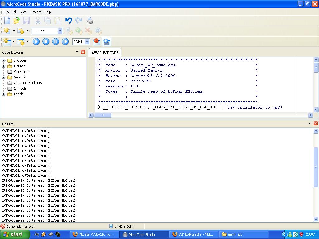

    Hi mister_e,
    you are right...but...
    i tryed to comment the lines :
    'DEFINE ADC_BITS 8 ' Number of bits in ADCIN result
    'ADCON1.7 = 1 ' Right Justify AD result
    and
    'adcin 2,value
    and still the same errors
  2. #122
    mm, i don't remind to already have this problem... token and line # mmmm
    which compiler and which version are you using?
  3. #123
    Yup, it's probably the version.
    In Post #110 there is an image from Marin that also has the same "Bad Token" errors.
    Attachment 1922
    The problem was PBP version 2.30 (it's just too old)
    HeHe: Beat him by a minute
    <br>
  4. #124
    @ post 110, i think i found 1 solution... or at least some tips... configuration fuse does not seems to be the one for an 16F877 anyways, and the comment should use ; instead of '
    for this one... i don't know .. still thinking of the version !
  5. #125
    yeah...i guess it's the version as my version is old as well.
    thanks anyway
