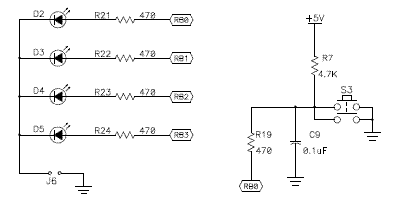

    Looking at the PICDEM2+ schematic some more, it seems that there might be a conflict with PORTB.0
    <img src=http://www.picbasic.co.uk/forum/attachment.php?attachmentid=1794&stc=1&d=118289364 1>
    With J6 installed (has to be for the LED on PORTB.2), the LED on PORTB.0 may not allow the voltage to rise far enough to register a HIGH level.
    <br>

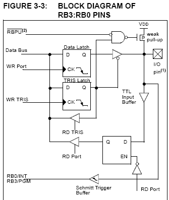

    If you look at the PORTB.0 diagram. You can see that it uses a TTL input buffer when reading PORTB as digital inputs. So, the High and Low voltage levels are 2.0V and 0.8V.
    With the circuit on the PICDEM2+ you'll get around 2.25V with the switch open (depending on the forward voltage of the LED). So it works fine with the digital Inputs.
    <img src=http://www.picbasic.co.uk/forum/attachment.php?attachmentid=1800&stc=1&d=118290623 7>
    But the signal for the INT interrupt, goes thru a Schmitt Trigger. And it's levels are .8VDD (4V) High, and .2VDD(1V)Low.
    The circuits on PORTB.0 of the PICDEM2+ don't produce enough voltage to trigger the interrupt. (when the LED's are engaged)
    HTH

    Darrel, your suspicion of PICDEM2+ were confirmed! Damn, so many ours wasted over a stupid LED!
    Thanks for the help guys!

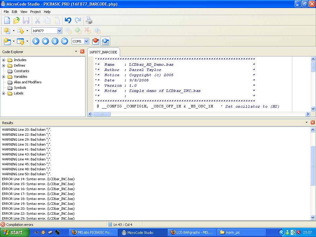

    I've try to get some bar from this and I've got problem as usual ;-)
    So this is little code from me:
    INCLUDE "LCDbar_INC.bas" ' Include the BARgraph routines
    DEFINE LCD_DREG PORTB
    DEFINE LCD_DBIT 4
    DEFINE LCD_RSREG PORTB
    DEFINE LCD_RSBIT 1
    DEFINE LCD_EREG PORTB
    DEFINE LCD_EBIT 0
    DEFINE LCD_BITS 4
    DEFINE LCD_LINES 2
    DEFINE LCD_COMMANDUS 2000
    DEFINE LCD_DATAUS 50
    INPUT PORTA.0
    i var word
    LCDOUT $FE, 1 'clean screen
    while PORTA.0 = 0
    i = i+1
    LCDOUT $FE,2,"Value = ",DEC i," "
    ' syntax- BARgraph Value, Row, Col, Width, Range, Style
    @ BARgraph _Value, 2, 0, 16, 255, lines
    Pause 100
    wend
    As You can see in picture I've got problem when compiling with LCDbar_INC.bas...and get'+s lot lines of syntax error in INCLUDE file......off course I didn't make anything to this file...just copy -> paste....
    Do You know what couses this problem?

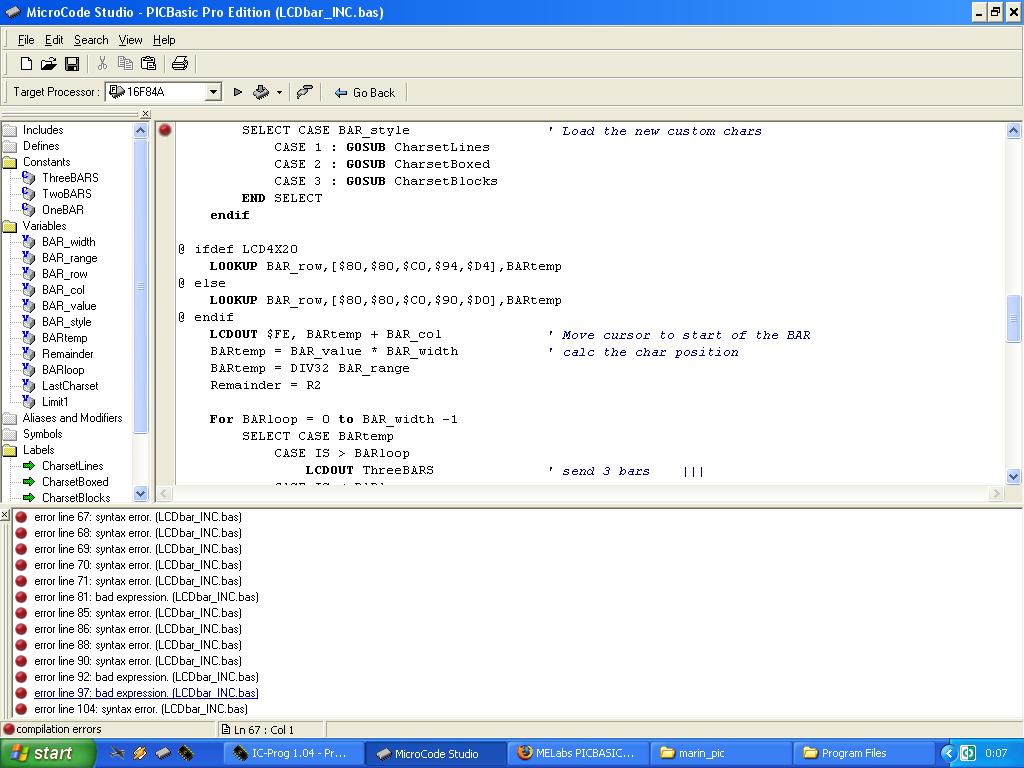

    Aug 2007
    26
    NOW, I download latest version of microcode studio and I'm using MPASM...and still have same problem....
    With other mine code MPASM works great without any mistake.....but when I try to put bar code rutine as INCLUDE it gives me many errors....
    Like YOu can saw on picture!!!!
    Only one strange thing occured:
    Everytime when I start CodeStudio.exe give me this message:
    The procedure entry point ThunkConnect32 could not be located in the dynamic link library KERNEL32.dll
    BUt, like I said...everthink wrks good with mine codes......

    If you want to send the .LST file to me, I can take a closer look.
    Email to darrel at PBPgroup.com.
    It'll probably be too big to post in the forum.

    The problem is I don't have LST file......Ionly have LST file for code which is corectly assembled...for this no...when I try to assembled it it give me errors and stops.,
    And this is screenshot i forgot to send:

    I did install MPASM and when I buil other code it works perfect and MPASM window pops up while compiling......so I think that's ok....
    Gonna try reinstall PICBASIC OR mpasM AND GONNA SEE.....

    You might try downloading the LCDbar_INC.bas file again.
    I've heard a couple people say they got incomplete files on the first try.
    After downloading again it worked.
    The compiler is flagging errors, that should not be errors.
    A semicolon is the comment character. It should be ignored, not an error.
    What version of PicBasic Pro do you have?
    It is PicBasic Pro, right?
    Not PicBasic.

    I downloaded code many times and always same problem remaining!
    Mecanique Micro Code Studio Plus
    Version 2.2.1.1
    Compiler Version is PicBasic Pro 2.30
    Yes....and MPASM is checked in complier options...and MPASM functioning ok with other codes!
  36. #116
    PicBasic Pro 2.30 ??
    Well there's the problem.
    That's waaaaaayyy too old.

    Hi guys,
    does this work with a pic 16F84A ??
    I get many strange errors !
  38. #118
    Does it say something like "... Least significant bits used" ?
    If not, What errors are you getting?

    i've imported the folowing code from this thread:
    DEFINE OSC 4
    INCLUDE "lcdbarIN.bas"
    ' Set LCD Data port
    ' Set starting Data bit (0 or 4) if 4-bit bus
    DEFINE LCD_DBIT 4
    ' Set LCD Register Select port
    ' Set LCD Register Select bit
    DEFINE LCD_RSBIT 2
    ' Set LCD Enable port
    ' Set LCD Enable bit
    DEFINE LCD_EBIT 3
    ' Set LCD bus size (4 or 8 bits)
    DEFINE LCD_BITS 4
    ' Set number of lines on LCD
    DEFINE LCD_LINES 2
    ' Set command delay time in us
    ' Set data delay time in us
    DEFINE LCD_DATAUS 100.
    DEFINE ADC_BITS 8 ' Number of bits in ADCIN result
    ADCON1.7 = 1 ' Right Justify AD result
    Value VAR WORD ' Must be a WORD even though AD is 8bit
    LCDOUT $FE, 1, " "
    loop1:
    adcin 2,value
    LCDOUT $FE,2,"Value = ",DEC Value," "
    'syntax- BARgraph Value, Row, Col, Width, Range, Style
    then i get :
    Error line 14: syntax error - this one i believe it's the ADCON1.7 = 1 command
    Warning Line 15: Bad token ";"
    bad expression
    Warning Line 16: Bad token ";"
    bad expression
    Warning Line 17: Bad token ";"
    bad expression
    Warning Line 18: Bad token ";"
    bad expression
    Note:
    The INCLUDE "lcdbarIN.bas" line where the name of the bas file is different because i also had to change to a smaller name due to "cannot include...etc" error
  40. #120
    mmm, as far as i know... grandpa 16F84 have no A/D converter ... so ADCIN will never ever works with... hence why you have some strange error... i missed that forum
