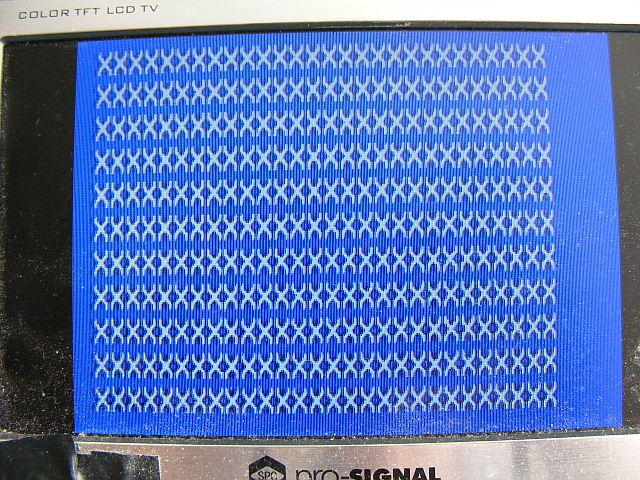

    My code does not work!! NTSC. no longer displays which is understandable. The code complies and when I run it nothing is displayed! Must have missed something basic?

    I now have worked out getting all lines on screen, it is combined with position and line characteristics. Removed the border area around the characters
    Here are the values I have used to get the attached picture.
    WDATA Values to be changed to values below
    In init routine
    WDATA = %0001001100001111 ' was %0001 011111 001111
    GOSUB Send ' Position ADDRESS 15 *****
    and in this
    FOR ICOUNT = 0 TO 10
    WDATA = %0001000010000001 '<<<<<$10c4 originally
    ' WDATA =%0001000010000111
    GOSUB Send
    NEXT ICOUNT
    that should! sort the screen out.
    Quick and dirty code to do screen fill as a subroutine - modified CLS routine
    Run it with no external video input
    This is where I put the call, once it has done the Xs it will not go further remeber to comment out GOSUB HEADER.

    FILLSCREEN:
        'character=$0B       'SPACE
         TEMP1=0   ' LINECOUNTER
         TEMP =0    'CHARCOUNTER
    loop2a:
    	WDATA = 0  ' LINECOUNTER*256 + CHARCOUNTER   ADDRESS
        GOSUB Send
    LOOP3a:    '                :CHARACTERS 100011
    	WDATA = %0001011101100011  '     X CHARACTER
    '   WDATA = %0001011101110111
    '    if temp1 =0 then WDATA = %0001011101110111
        if temp1 =1 then WDATA = %0001000001100011
        if temp1 =2 then WDATA = %0001000101100011
        if temp1 =3 then WDATA = %0001001001100011
        if temp1 =4 then WDATA = %0001001101100011
        if temp1 =5 then WDATA = %0001010001100011
        if temp1 =6 then WDATA = %0001010101100011
        if temp1 =7 then WDATA = %0001011001100011
        if temp1 =8 then WDATA = %0001011101100011
        if temp1 >=9 then WDATA = %0001011100100011
        GOSUB Send
    	TEMP = TEMP + 1
    	IF TEMP >= 28 THEN
        TEMP = 0
        TEMP1=TEMP1 + 1
    	IF TEMP1 >= 11 THEN SCREENBLANKA
        GOTO LOOP3A
    SCREENBLANKA:
    Thanks, Ed
  36. #76
    Default Re: A little HELP!!
    rows 1-9 as white squares while rows 10 and 11 are X's
    if temp1 =8 then WDATA = %0001011101100011 = white square
    if temp1 >=9 then WDATA = %0001011100100011 = X
    Also remember rows are 0-10 not 1 - 11
  37. #77
    Mar 2011
    Los Angeles, California
    322
    Thanks Aerostar,
    Just another brain cramp on my part. As long as the background is blue then color squares appear. With video, only white squares. I keep searching the internet for a chip that will produce color with a video input and not a generated background. I cannot believe no one has or makes such a chip!
    Best, Ed
