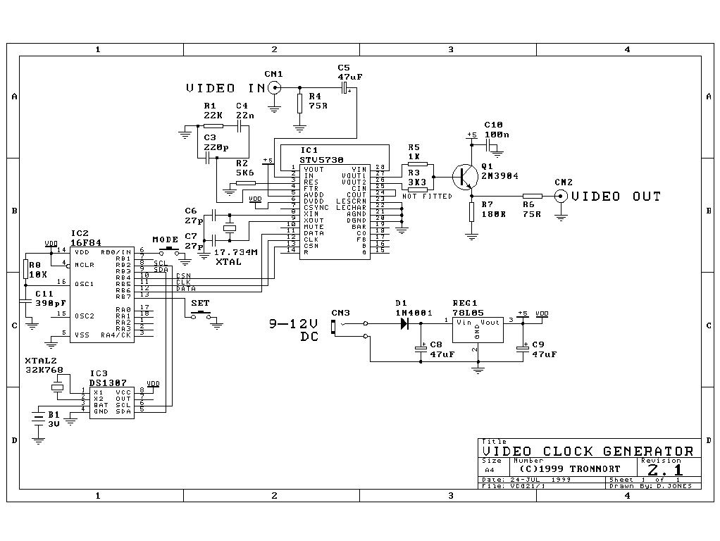

    Okay so I am still struggling with this code. In television there are three forms of video standards for different parts of the world. There is NTSC, which is the American standard, PAL a European standard and SECAM another standard. Most of the world uses either the NTSC or PAL standard. The basic difference is weather the power is 50 cycles per second (PAL) or 60 cycles per second (NTSC) as this is used for the timing of the television electronics. Since this STV5730 seems to display an out of sync picture most of the time my guess is that the code has the PAL standard embedded somewhere in it. I can see a display for a short time with the characters in the PIC code then it goes back to a scrambled sync signal. I have never seem an "overlay" display where the characters are superimposed over the incoming picture. I am hoping someone with much, much more knowledge than I have can tell me what to change in the code? Thanks in advance.

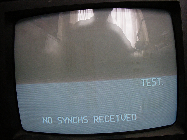

    Default Re: A little HELP!!

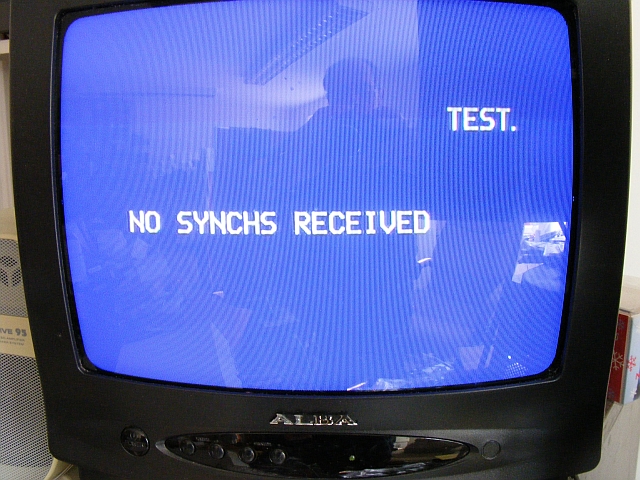

    Hi, I have dug out some code I used for this chip, but it is PAL, you should be able to change the appropriate bit(s) to NTSC.
    It puts the word TEST. on 3rd line at right hand side of the screen.
    It also detects synchs and will auto switch mode as necessary, and when there is no incoming video it will display that No Synchs message on screen.
    I have modified the code from the original, it had a lot of debug stuff in it, I have not tested since although it should work, (it compiles OK) , I post to let you check the values in the code you have.
    I will try and test in the next few days when I get some video stuff resurected.
    Just a note it is much easier to put the values in as binary eg %0000000011001100 rather than have to work it out when debugging.

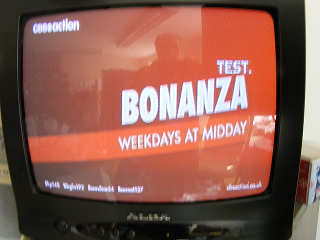

    I have compiled and programmed a 16f628a and it all works fine.
    Pics a bit fuzzy due slow shutter.
    Remember the code posted is the PAL version you need to change the bit(s) for NTSC.
    Cannot test on NTSC as no suitable equipment.
Size:  246.1 KBName:  STV-TEXTMODE.JPG

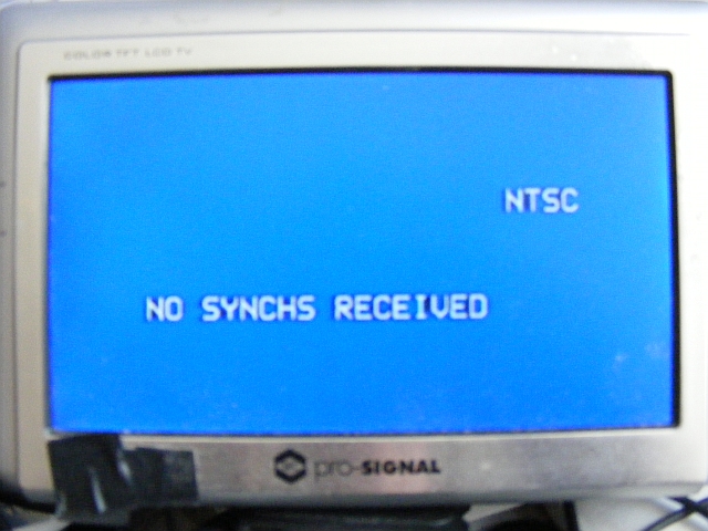

    I have got the monitor that does NTSC, changing the appropriate bit 8 in the register 14 and with the 14.318 xtal in the STV board, I get a picture with readable text, see below.
    However the display is not in the correct place and there is no colour. Further investigation needed!!
    It sort of looks like the timing is wrong somewhere probably another setting needs to be changed.

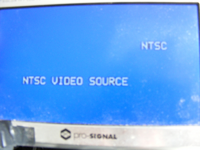

    News
    I have NTSC display full colour and in the correct position. Problem was low voltage on my STV board, when that was fixed it worked straight away.
    Code attached
    Program your 628a with the hex code, if it works on your 628A then you have a compiler prob or something, if it does not work you may have a naff 628a.
    Also I compile with Picbasic Pro Ver 2.60C - I think you compile using MPLAB, not sure of your PB version, try compiling the 628a code with the PBP compiler.
    heartbeat led remarked out
    cmcon added in, but not needed as you are not using port A
    TRIS B changed to reflect your ports use.

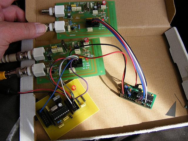

    Here is code, hex file and other files made by PBP3 , Microchip assembler, tested working with my NTSC source.
    I used a second STV NTSC board as the video source (top board in picture) , connected that output to the input of the original board board (bottom board in picture), and it switches back and forth OK.
    Top BNC is video input, bottom BNC is video output on the boards. Micros are 628a pics
    With no input to the bottom board, you see the NTSC. and the No synchs message, with NTSC input from the top board, bottom BNC, NTSC. is overlayed on the incoming video, my top board board puts out NTSC VIDEO SOURCE.
    Compiled (with help of friend) PBP 3.1.0.1, mplab 8.92 MCS version 5.00.5 and programmed with pickit 2 v2.61 programmer. this I think matches your software setup - your programmer unknown.
Size:  223.8 KBName:  Test setup.jpg

    And to prove it really does work - see below - wobbly camera as it was my phone and had to have the other hand to make the connection to the top board at the same time.
    Part of the PCB lay out was on the net way back 2003 or earlier, done with the free version of Protel as was then, I modified it to fit what I wanted and had the boards made as it was a commercial job. The text was only used as white but should be able to change using the color register I think.
    If I get chance I will see if I still have the board layout - it will take a day or more - have to dig in to old backups etc and when I get the time.

    From the depths of the old files I found this -
    On the STV PDF, it shows Circuitry around pins 5 and 6 I incorporated this, but I see the schematic above does not, I think as long as you have a good smoothed 5 volt power supply with good decoupling caps, there should not be a problem. However he does not show decoupling caps on his 9-12V DC circuit, 100N/220N should be in parallel with his 47uF caps and be close to the regulator.
    On my board R3 (3k3) not fitted, My board, and the program you have uses CSYNC to work out the switching of modes, from what I remember I found odd problems using the MUTE, but cannot remember exactly what ! I think it did not always change the level when it should have or took a while to change.
    Different coloured characters, It is in
    DISPLAYCHAR:
    WDATA = %0001011100000000 + STVCHAR
    Bits 10,9, and 8 internal ram buffer, page 7 of my PDF, according to the STV data control the colour of the character.
    You will have to try that when you get your system running correctly
