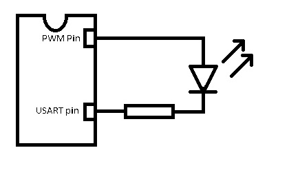

    Jan 2006
    Istanbul
    1,185
    Lightbulb Re: srial over the IR
    If the received data is like a garbage, then reverse IR LED legs.
    Jun 2008
    Varese , Italy
    326
    Default Re: srial over the IR
    good idea Sayzer,
    thanks,
    Ambrogio
