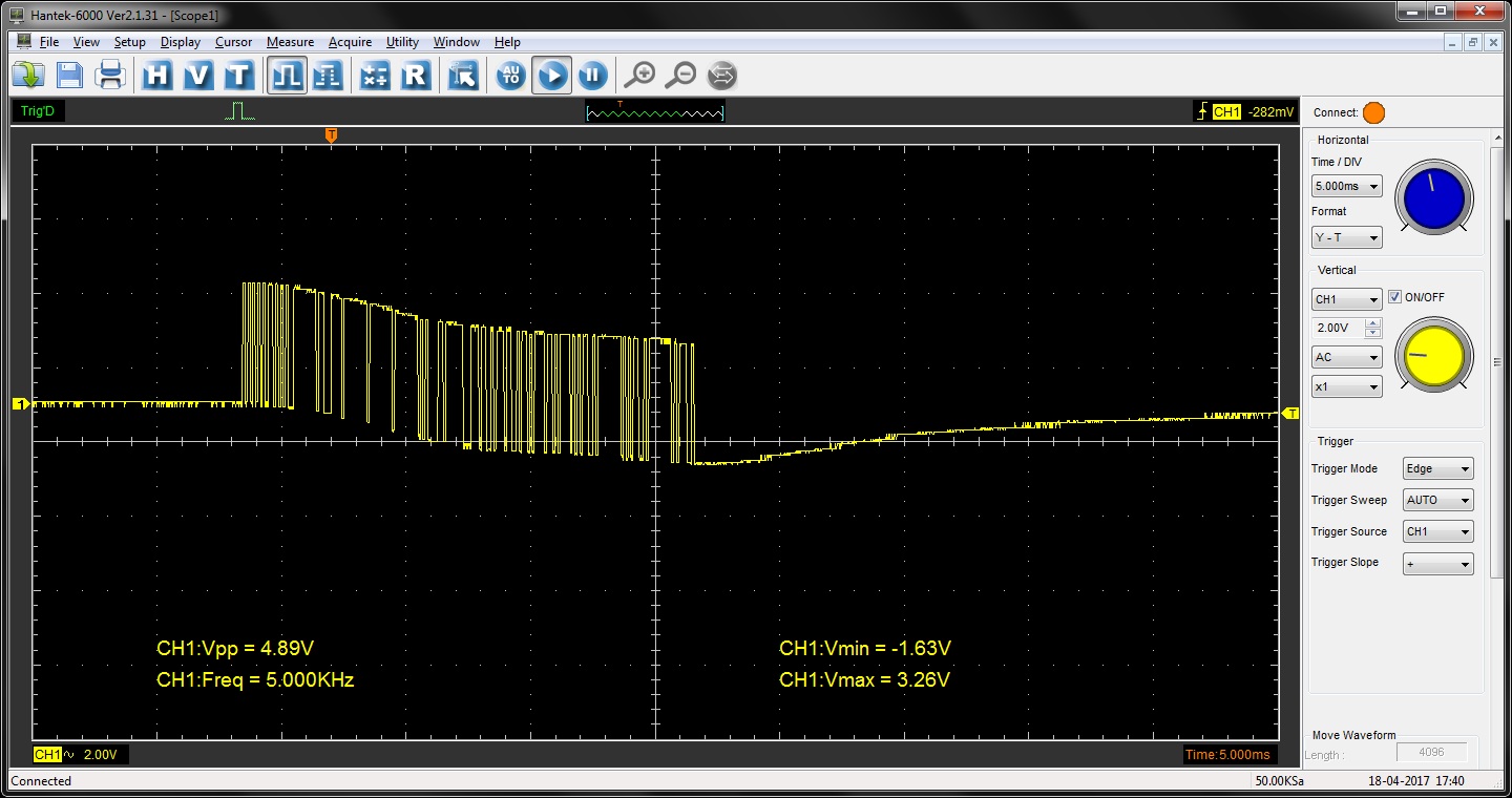

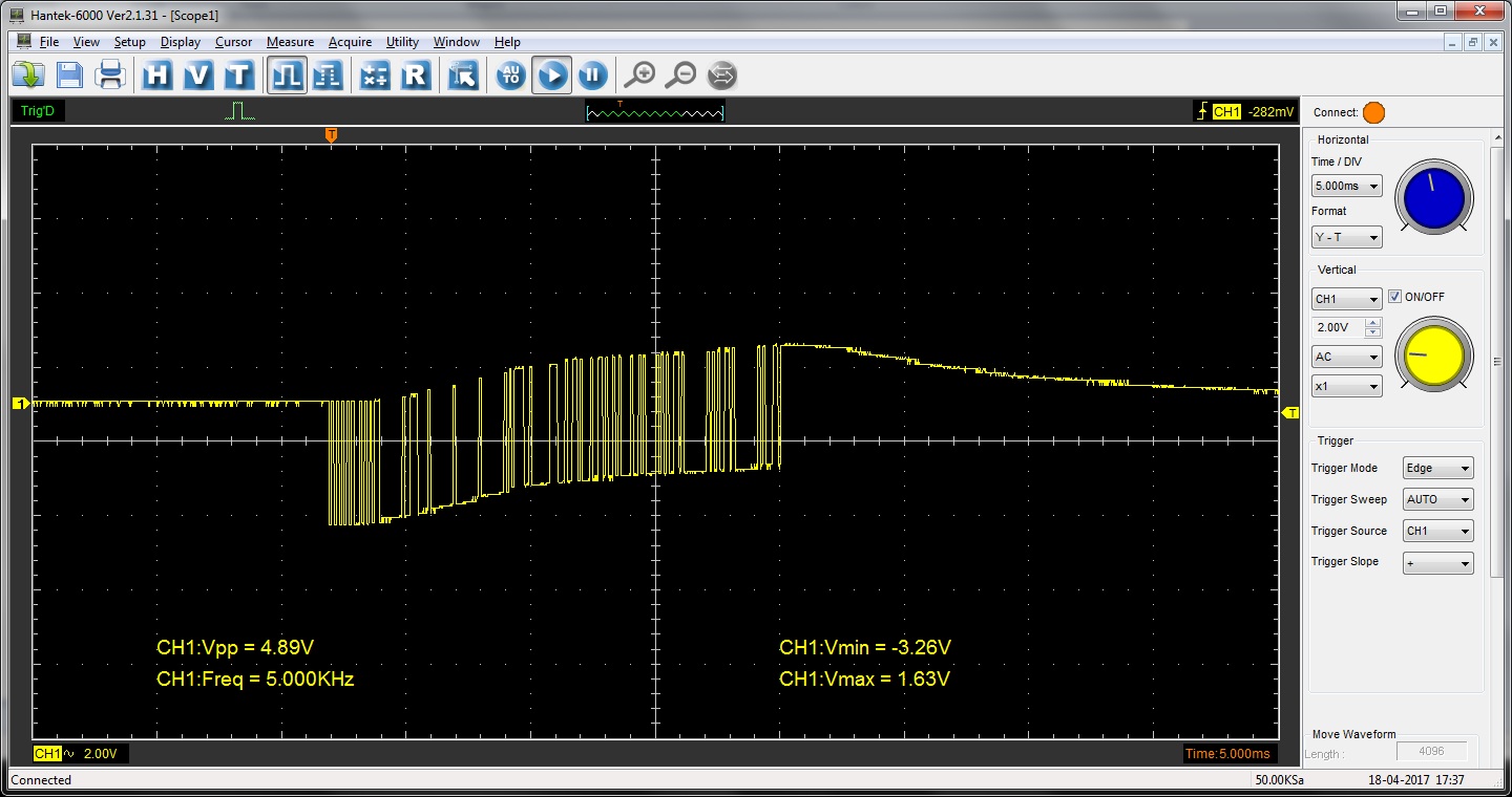

    I am brand new to the Forum. Does anyone know if "SEROUT" wave is formatted to UART or RS232 format, I have been in contact with a Wi-Fi module chip manufacturer with a request of "Do I need to install a MAX232 chip to clean the wave from PicBasic function called "SEROUT", there answer was ""If the device connect to Wi-Fi module is RS232 interface then MAX232 chip is needed but not if UART".
    The Wi-Fi module is 3v3.
    Can anyone help with this question ?
    Attached is the oscilloscope readings from inverted 9600 baud rate and true baud rate, judging by the High/Low voltage's it should have a MAX232 installed Does anyone agree with me?

    You need to set your scope to DC coupling, not AC coupling.
    According to the USR datasheet the serial connection is 3V3 uart levels. No MAX232 should be used.
    You should run your pic at 3V3.

    Thanks TumbleWeed,
    The pic is running 3v3, my concern was that the generated signal from SEROUT was producing the signal in the images, but as you pointed out I set the sensor to DC from AC and the voltage measured 3v3(approx) so the generated neg-cycle was an error of the osciliscope.
    ya only get what you pay for
    So the answer is "SEROUT" produces TTL format
