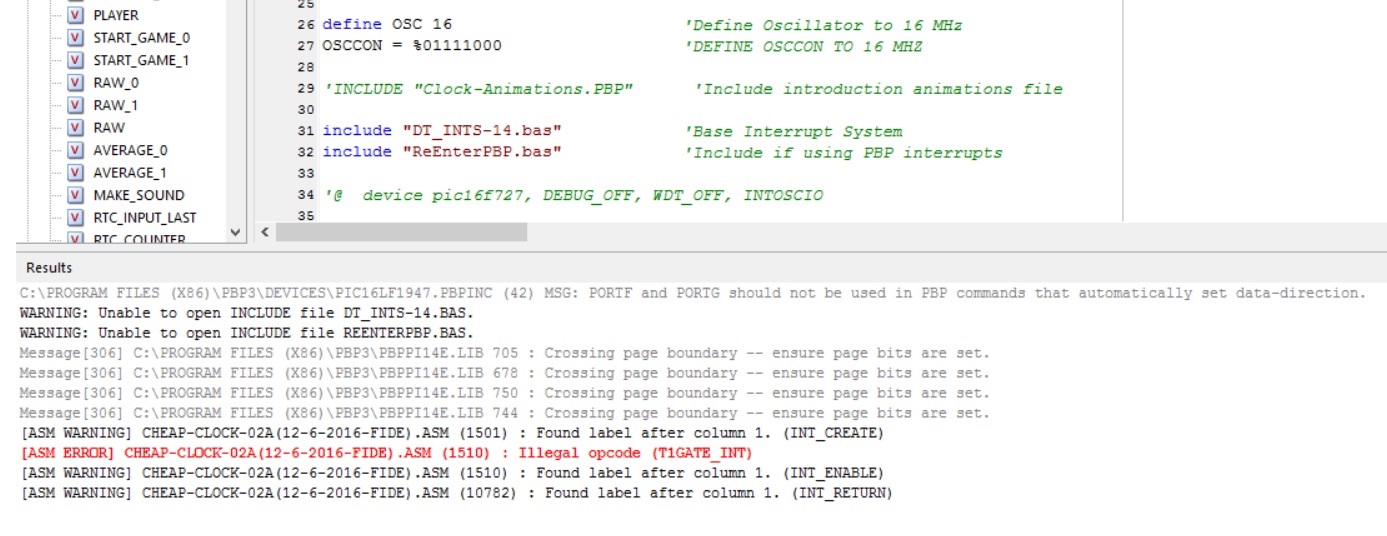

    I just bought my license for PBP3 after many years using PBP2.60 . I have a program that works perfectly fine with PBP2.60, but apparently PBP3 doesn't like DT interrupts. I got a bunch of errors when trying to compile my code.
    Apparently, PBP3 doesn't like the DT Interrupt files. Can somebody please point me in the right direction? I did a search here in the forum, but didn't find anything related to this issue. Any help is appreciated.

    Actually, I found the problem. The files DT_INTS-18.bas and ReEnterPBP-18.bas need to be included in the same folder with the pbp program. That resolved all the issues.

    It is not necessary to be in the same folder. If Include does show the correct path like this:
    Include "C:\myprojects\DT18INTS\DT_INTS-18.bas"
    you are good to go.
