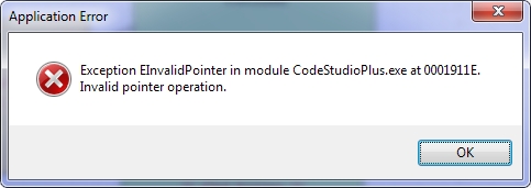

    Default MCS is Crashing
    I have had the MCS shutdown several times (gray-out) with a error screen. I believe this may have something to do with the file saving path. If I manually save my work every so often I have not experienced any problems. If I don't manually save the file and an auto save works is where I believe things go awry. I usually save to the factory default area under "My PBP3 Programs". Most of the time I will save the new rewrite to a flash drive under "Save As" and use this to copy over the old file on the same computer and over the same file on another computer. I am using all the latest upgrades and have had this happen several times after having 3 pages of code written on Toshiba running W7 and a newer Dell running W10. I'm sorry I didn't copy the error code. ( It said an exception error has happened with an address and MCS must shut down). I hope this helps someone to fix this issue. It is very annoying. Now I manually save after every page rewrite. Cheers.

    crashed again this morning, while typing a comment (same as always). Name:  mcs crash notification.jpg
    Faulting application name: CodeStudioPlus.exe, version: 5.0.0.5, time stamp: 0x2a425e19
    Faulting module name: unknown, version: 0.0.0.0, time stamp: 0x00000000
    Exception code: 0x00000000
    Fault offset: 0x00000000
    Faulting process id: 0x1fb0
    Faulting application start time: 0x01d2d7bae18ebaac
    Faulting application path: C:\Program Files (x86)\Mecanique\MCSPX\CodeStudioPlus.exe
    Faulting module path: unknown
    Report Id: 1f0308d8-43b0-11e7-a3d0-ac72892a9ffd
    and 23 seconds later,
    Faulting module name: ntdll.dll, version: 6.1.7601.23796, time stamp: 0x59028db3
    Exception code: 0xc0000025
    Fault offset: 0x000904b0
    Faulting module path: C:\Windows\SysWOW64\ntdll.dll
    Report Id: 2d149eb5-43b0-11e7-a3d0-ac72892a9ffd
    Any further suggestions?
    This is the ONLY program that halts and displays an error, ALWAYS when typing in comments.

    MCSX started crashing yesterday again. Did not matter which code file I tried to edited, any change in text caused the error message to pop up. I found that you can ignore the message and still compile the code and make changes. Out of frustration, I reinstalled pbp3 and mcsx. That did not help. On this laptop there was an old copy pbp 2.47. So I opened the file in this version without crashing. The only problem was 2.47 did not support my pic. I dug out my 2.60 cd which supports my pic and then patched it with the last update before pbp3. The 2.60 cd had MCS 3.3, now I'm back in business and on this pc done with pbp3/MSCX.
    If anybody wants me to run any experiments let me know. Because it can be repeated. It would be nice if MEL could un-marry pbp3 from MCSX and allow the use of older versions of MCS. I am sure there is reason it can't be done.

    Mark, that's interesting,
    I'm running version 4.0.0.0 of MCS, version 2.60c of PBP and an old version of mpsam suit (5.07 I think) and I've been very lucky as I've never had a crash whilst coding or compiling etc. Yes I know the restrictions this combination has, but for me and the projects I undertake, the supported chipset is fine.
    I don't have the needs to upgrade to PBP3 so my input may be irrelevant, but I hope that someone can sort out this issue for those who have had to upgrade in order to remain competitive
    Oh and the PC is an AMD 6 core processor running at 3ghz, 12gb DDR3 ram, and windows 7 professional 64bit .... Are those experiencing this issue running windows 7 or later versions... maybe (clutching at straws) it only affects those running windows 8 or 10 ??

    As I've said, I've had it crash at home and at work. One machine running W7 Home 64bit Swedish with the bought MCSPX, the other running W7 Pro 64bit English with the free MCSX. Both PBP3.0.x.x
    At home I've upgraded my personal license to PBP3.1 on a brand new machine running W10 Pro but haven't been doing much with it lately so it's still low mileage (very much so).
    I'm not a PC software developer but I'm pretty sure it's got nothing to do with the compiler, it's not when compiling/assembling that it crashes, it's when typing in your program. I've got screencapture (video) of it doing it if that would help....

    As Henrik points out it's not pbp3, the problem is MCSX. MCS is stable but pbp3 will only run on MCSX. A lot of software developers like to blame their bugs on WIN7,8,10. I am using XP and this pc is only used for programming pics. My home system is still stable so if I need something not supported by 2.60 it can get done.
