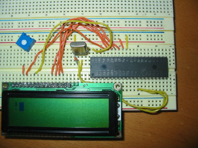

    I'm sorry, I know that this is a PIC Basic forum thats why I hadn't posted my code In the first thread. Yes, I have a pullup on MCLR, and LVP is off. Here I have a picture of what my screen shows when my program tries to write "Hello world!!!"

    I was just looking at your picture an couldn't help but notice the leads coming for the crystal. Shouldn't there be a empty space in between the pins. It looks like the pins are spaced at 0.100". It might be just the picture but I think the crystal is actually 0.200" pin spacing.
    My 2 cents... the crystal is really to far of the PIC, and try to remove both capacitor... breadboard capacitance
    I actually found running 22pF with our PIC's caused us loads of troubles. Things would reset all the time, corrupt displays and sensors. Removed the capacitors and everything works fantastic now. Scope the ocsillator output and noticed the capacitors were actually causing a lot of noise.

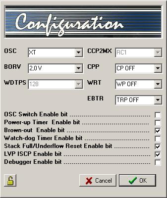

    Btw. here is a picture of my cfg.
    Tallinn, Estonia
    42
    Switch OFF LVP and BOR (brown-out-reset). If does not help, send your full code, i'll try to simulate it.
