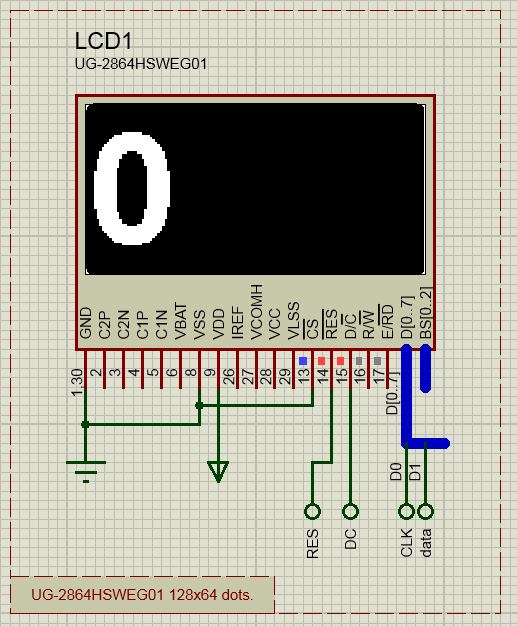

but it doesn't start at row 49... Always at ROW 0 !
I tried to see code from others (arduino too but they use libraries so... just crazy) but I can't see what's wrong.
