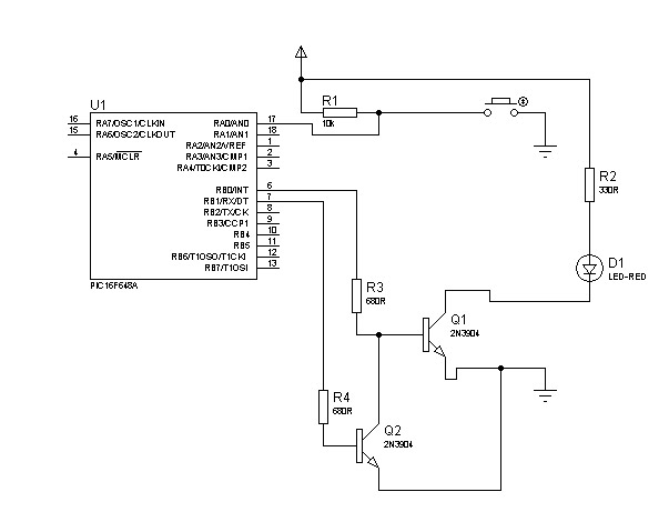

    I really , thank you for your working. I tested your code , that is not what i wanted .
    But , I already find a diffrent solution for my need .
    Example ;
    When you press a button , led will be high over a npn transistor. And a counter starting the count for 5 second .
    if button still pressed end of 5 sn , another output from a pic will be high over transistor which is connected first one from base - collector.
    It will force to down the first transistor .
    Otherwise , in 5 sec i release button it goes first statetment.
    Thanks everbody who helps .
    Not : If some body interset my code i can send to board .
    Jul 2005
    65
    Hi
    You can post the code here
    tanero's Avatar
    tanero Guest
    My code is that ;
    @ DEVICE pic16F648A 'Device 16F648A
    @ DEVICE pic16F648A, WDT_OFF 'Watch Dog
    @ DEVICE pic16F648A, PWRT_ON 'Power on Timer
    @ DEVICE pic16F648A, PROTECT_OFF 'Cod Protect Off
    @ DEVICE pic16F648A, MCLR_OFF 'MCLR pin is not used
    @ DEVICE pic16F648A, INTRC_OSC_NOCLKOUT 'Internal osilator used
    DEFINE OSC 4 ' Osilator frekans
    CMCON=7
    TRISA=255
    TRISB=0
    PORTB=0
    BUTTONINPUT VAR PORTA.0
    LED VAR PORTB.0
    KILLER VAR PORTB.1
    Counter VAR BYTE
    Counter=0
    Loop:
    While BUTTONINPUT=0
    High LED
    Counter=Counter+1
    IF Counter=50 Then High KILLER
    Pause 100
    Wend
    Low LED
    Low KILLER
    Counter=0
    GoTo Loop
