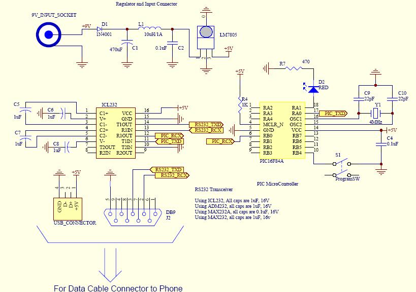

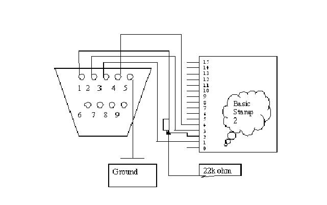

    Default Provide me the circuit please
    Connection
    1.DKU-5 cable connected to the Nokia phone.
    2.a male type connector connected to the other end of the DKU-5 cable
    3.from that connector I set up the connection to the basic stamp2 as shown above.
    4.by the following bs2 code I successfully sent sms
    SEROUT 1, 16572,25, [ "AT+CMGF=1" , CR]
    SERIN 3, 16572,[ WAIT ( "OK" )]
    SEROUT 1,16572,25,["AT+CMGS=",34,"+880191787670",34,CR]
    SERIN 3, 16572, [WAIT (">")]
    SEROUT 1, 16572, [“hello”,CR]
    SEROUT 1, 16572, [26,CR]
    SERIN 3, 16572, [WAIT ("OK")]
    DEBUG "ok"
    MY PROBLEM NOW IS, I MADE SAME CIRCUIT WITH PIC16F84A TO SEND SMS. BUT IT IS NOT WORKING. MY PICBASIC PRO CODE IS OK. I THINK (SURE) I COULD NOT MAKE THE CORRECT CIRCUIT FOR THAT. CAN ANYONE PROVIDE ME THAT.

  3. #203
    4,171
    Russel:
    Maybe if you interchange the tx and rx lines?

    i have implemented the given circuit(only the right portion).
    i used 8Mhz crystal.
    but no result.
    can you please help me.
  9. #209
    So i hope you have include the Max232 (icl232) too?
  10. #210
    4,171
    As Steve asked, did you used the 232 chip? What do you mean by "only the right portion"?
