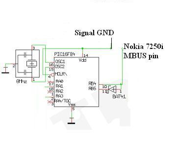

    Hi NavMicroSystems
    My aim is to send SMS using a Nokia 7250i phone using a PIC microcontroller most probably 16F877A, since
    it has hardware USART
    I went through entire thread from page 1 to 2. The problems I faced can be listed as follows
    1) I am a beginner so the schematic Stu746 told, had me in some dilema
    I thought only modifications to be done are to omit the PC part with two MAx232 ICs
    2) I have a Nokia 7250i : which has an embedded modem as I learnt from Nokia website - Solved
    But I have a DAU 9P-FBSU cable which I use to connect my phone with other third party
    softwares and it is successful. But using Hyperterminal it is not responing to any AT commands. Do I
    need an DLR 3P cable. How can I do it with my DAU 9P FBUS cable...?
    3) To my knowledge phone voltages are between 3.6 and 5V so why we need a MAX232 IC to connect
    the phone to a PIC. We may need it in case we are connecting it to PC COM port. where voltages are
    between +15 and -15V. This contradicted with the NavMicrosystems post on 24th February 2004, 22:05
    Unless of course you are using the phone datacable inbetween !.
    For your reference I have attached the circuit I built.
    regards

    aruran,
    I'm sorry, but I really can't tell which cable to use with the 7250i.
    For my tests I used a 6210 with a standard (NoName) Data cable.
    All I can tell is:
    If your Phone doesn't respond to AT-commands sent from Hyperterm there is most likely something wrong with your cable.
    I had two different cables, one did work, the second one didn't. I haven't taken the time to investigate in detail what the difference between them was.
    To find out which cable works with your particular phone (or how to build your own) I guess you will have a better chance on one of the many GSM-Forums.
    regards
    Ralph

    So If I build the circuit I attached in my last post, it should work is it. Of course connecting the MBUS properly to my Nokia 7250i
