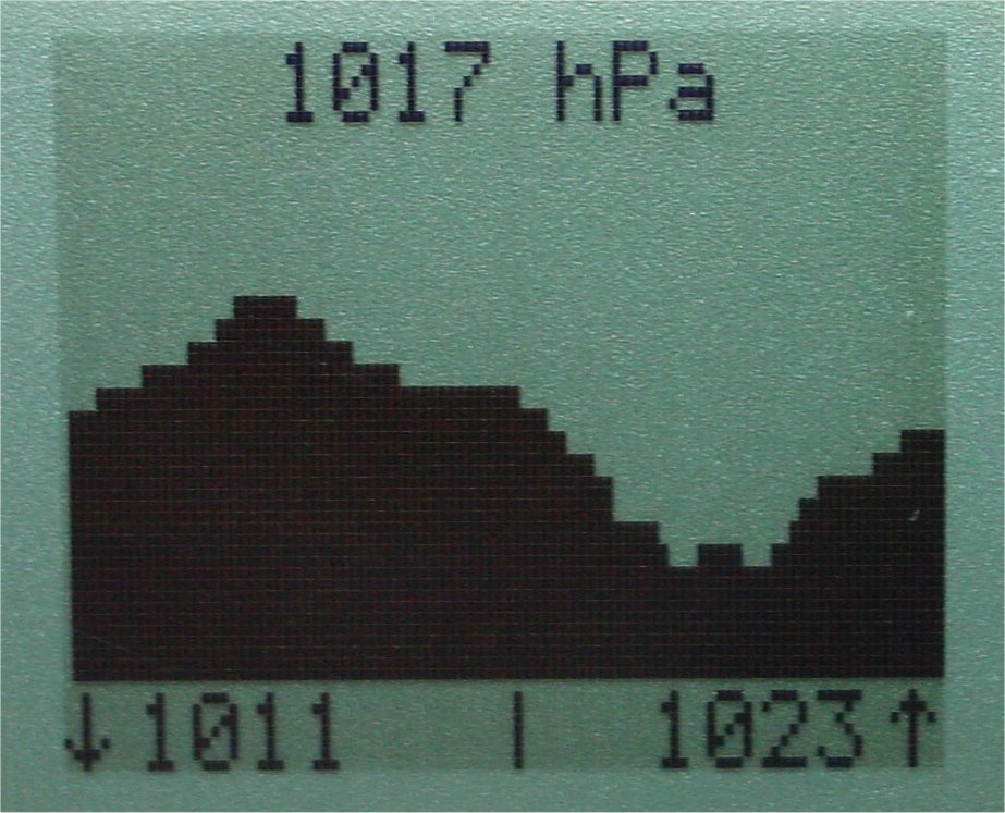

    Attached if an image of one of my projects built around my "favourite" $0.75 Cellphone LCD.
    regards
    Ralph
