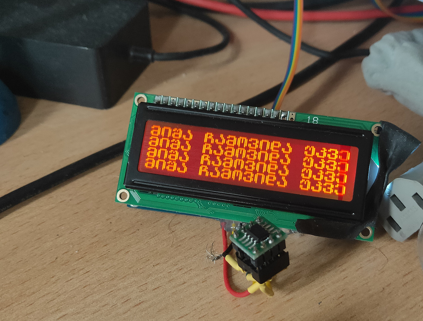

    Currently I'm doing this in the following way:
    FOR X=0 TO 17 step 2	'READ ARRAY INTO VARIABLE, ARRAY MEMBER CHAR=EEPROM OFFSET
    Y=topline[x]
    Z=topline[x+1] 'READ  INTO VARIABLE AS TWINS
    FOR I=0 TO 7	'HELPER LOOP FOR CHARACTER READING
    READ Y+I,A 'READ EEPROM BYTES INTO VAR
    READ Z+I,B
    LCDOUT $FE,$80+i+c 'UPDATE Y POSITION
    LCDOUT $FE,$80+x/2 'UPDATE X POSITION
    if y=255 then a=0
    if z=255 then b=0 'blanker for space display
    LCDOUT a
    LCDOUT b 'WRITE TO SCREEN
    NEXT I
    NEXT X
    C=number of line*8 where text had to be displayed.
