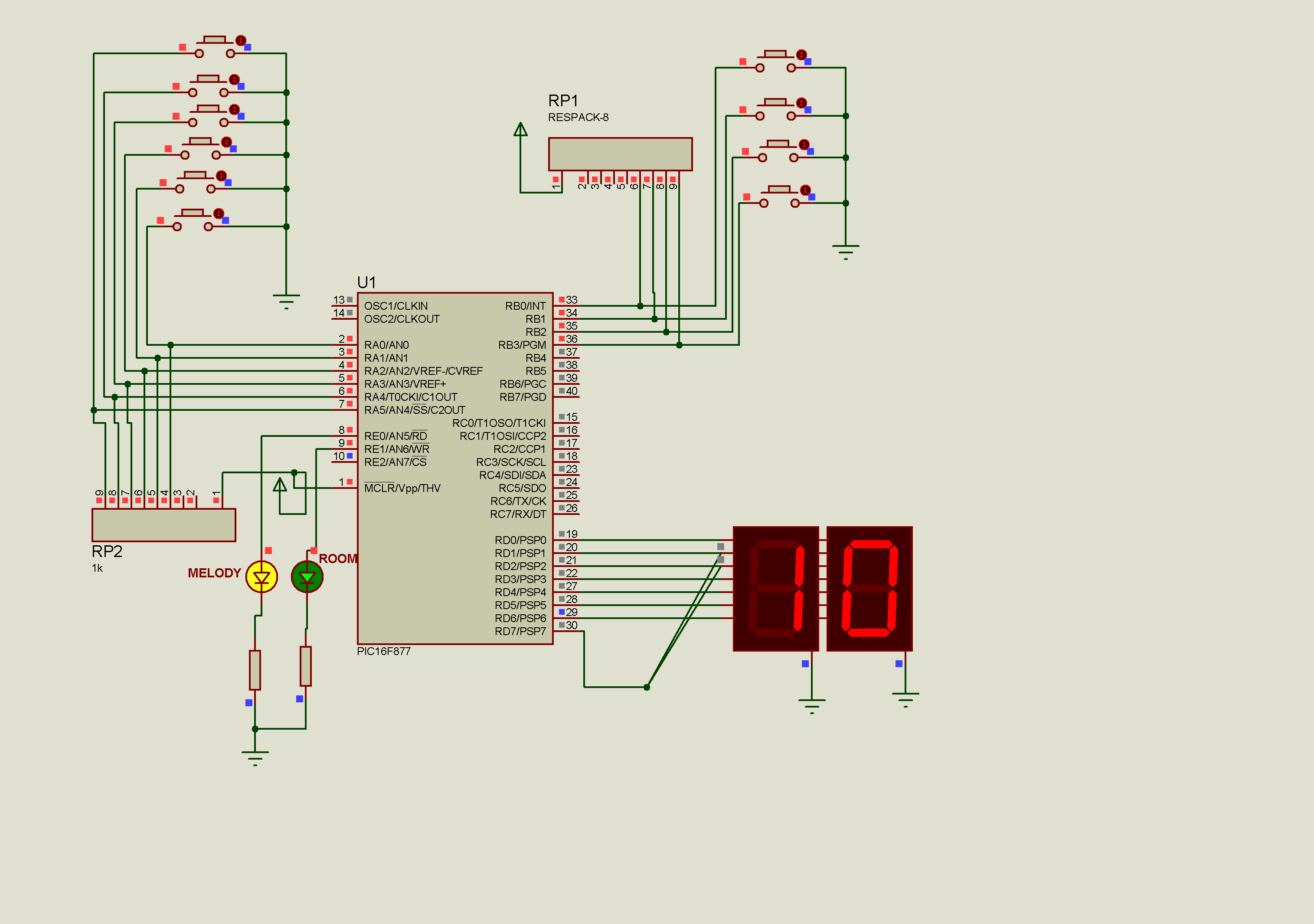

Nurse Alert System
Results 1 to 7 of 7
    Apr 2011
    5
    Default Nurse Alert System
    Name:  N Alert.PNG

    Ten rooms Nurse alert system. I hope someone finds it useful
    Default Re: Nurse Alert System
    Nice.
    Maybe resistors on those LED segments?
    Apr 2011
    5
    Thanks Robert, yes in real life, limiting resistors will be needed.
    Mentor, Ohio
    352
    Hi Fidelus,
    Are you planning on using this commercially? If so you might want to contact U.L. for the requirements for getting a U.L. listing which will be required by your customer's insurance company. 10 years ago I designed, built, and installed a system that covers an emergency pull cord system and a check in system for 160 apartments and asked the customer for their specific requirements. He didn't provide any so they got a pretty nice system without spending a lot of money on U.L. testing. This should really be left up to the companies that make systems for this purpose.
    BobK
    2,722
    some thoughts
    what happens if two or more rooms signal simultaneously ?
    what happens if the nurse is absent/distracted for more than 6 seconds ? there is no record or indication of a calls source or that a call ever happened .
    do all rooms have equal priority ?
    Apr 2011
    5
    Thanks guys,
    The System presented here is really basic and has no record for missed events. However, making it into a commercial system will not be a bad idea, i think.
    Thanks.
