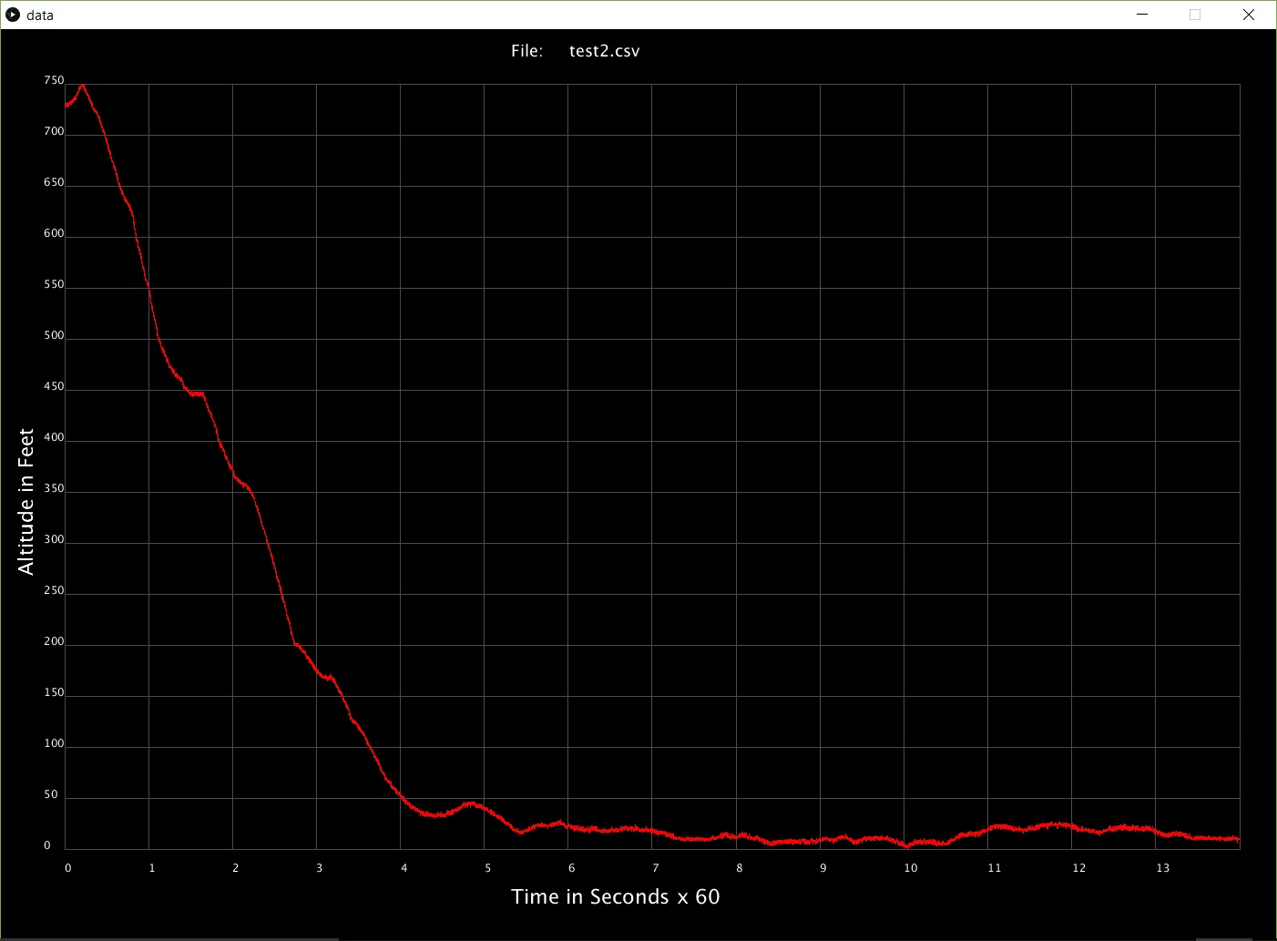

    I have been working on a hobby project, telemetry on a model rocket, and wanted to be able to display some nice graphs from the data it generates. There are a lot of examples on how to use processing for different applications on-line. It's pretty easy to grab data from a serial device (such as a PIC, or a PIC connected to a data radio), and have a base computer log the data into a .csv file. Graphing was a little harder to find examples for. Hopefully this will help someone that might be interested in using Processing to enhance their project. Hope this gets some people thinking about how they might use it in their projects.
    Here are a few of the things that my program does:
    1. Scale the graphs so that 30,000 foot flights, and 300 foot flights would both max the scale of the graph.
    2. Allow you to scroll through the different flight .csv log files within the directory with your mouse, and have it draw a graph of the data
    3. Allows for portability by allowing for different display sizes without screwing up the graphs
    I don't have any actual samples from any test flights yet .... so collecting altitude data while driving some hills in my car had to suffice. Notice the units change between some of the sample files.
    The graphing program (data.pde) can be downloaded here along with the samples: https://github.com/radiohound/NXPMot...RocketNXP/data

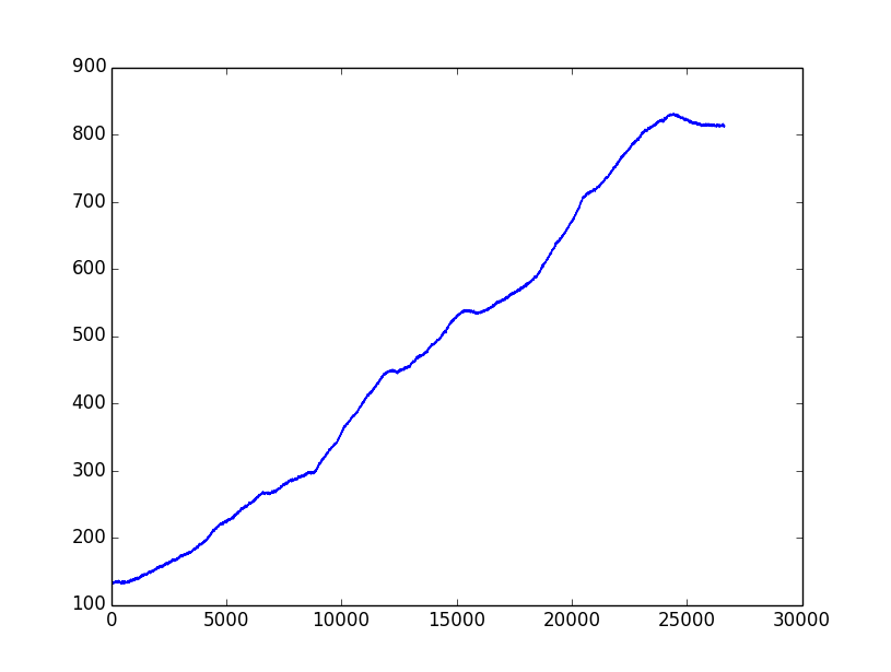

    interesting hobby , would like to see real data
    just for comparison I did this with python, python allows you to zoom in/out on any portion of the graph and save it a png,pdf or whatever too
    for just a dozen lines of code
    import csv, sys
    import matplotlib.pyplot as plt
    filename = 'candaroad.csv'
    t=[]   #time
    a=[]   #altitude
    with open(filename, 'rb') as f:
        reader = csv.reader(f)
        for row in reader:
                #print row
                a.append(float(row[4]))
                t.append(float(row[1]))
    plt.plot(t,a,'b-',label='altitude')
    plt.show()
    #print a
    graph looks a bit different to yours , I may have misinterpreted the data
    O:,359.54,-16.05,5.61,577.59
    O:,359.72,-15.96,5.55,577.02
    O:,359.82,-15.97,5.59,576.49
    O:,0.00,-15.96,5.55,576.06
    O:,0.14,-16.01,5.50,575.67
    O:,0.25,-15.96,5.53,575.77
    O:,0.40,-15.97,5.48,575.86
    I assumed the 577.xx is height and 359.xx is time but the time figure seems to rollover at 360 so I must have guessed wrong

    derr ,I get it the readings are at 1sec intervals

    Wow Richard,
    That's very impressive what Python can do with so few lines of code! The readings are received at a rate of 100 times per second, but yes, that is basically it. I am sure I can zoom in and out as well .... with only 50 more lines of code
    I am also using processing to show the 3d orientation of the rocket during flight, as it records the flight data. But I have seen people do the 9dof orientation displays with Python as well.
    Yes, I am anxious to see get some real flight data too. I am curious how the 9dof will report 3d orientation while in flight, and how well the filtering of the altimeter will work in flight conditions.
