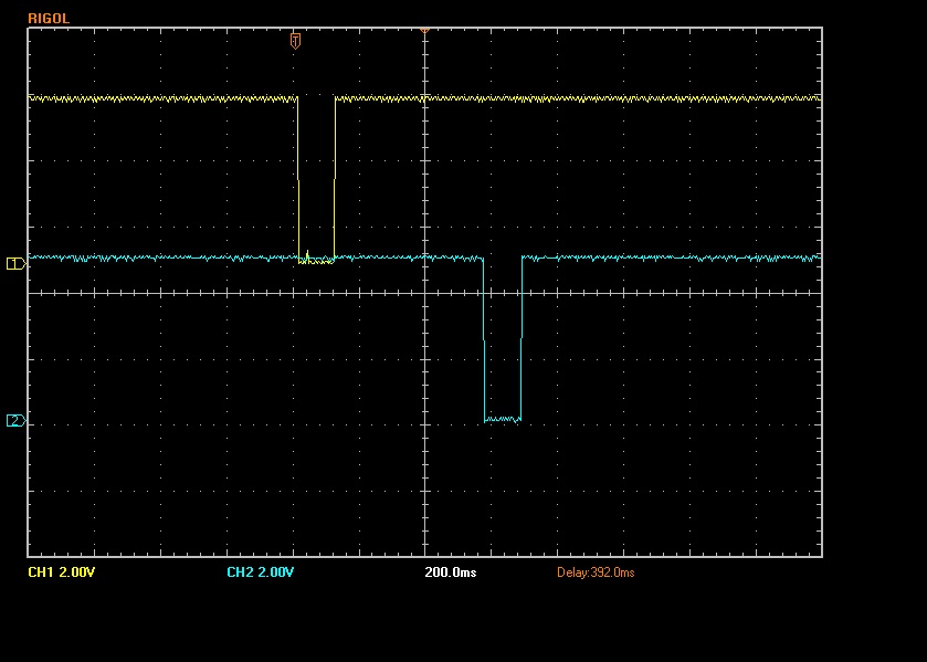

    the problem im seeing is my loop time on p4 is around 3hz, whereas the loop time within the for..next loop is around 3khz
    so even if i up my clock speed to 20mhz it looks like its still not going to be fast enough to do this?
