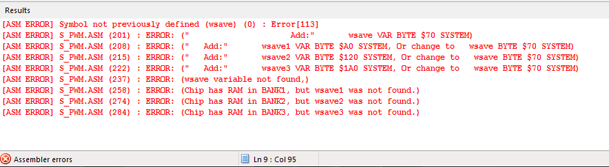

    I am using http://www.dt-ints.com/DT_INTS-14/SPWM.html SPWM_INT in PB3. Getting following error. Seeking help. Thanks in advance.Name:  error.png

    That particular error message is nice because it actually TELLS you what you should do to resolve it, namely add:
    wsave   VAR BYTE    $70     SYSTEM
    to your code...

    Perfect!!.. Thank you Henrik :-)
