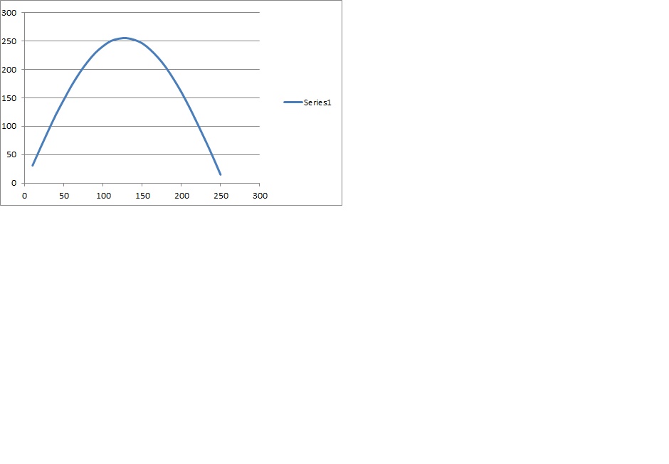

    should be easy with a PIC12F1822 @32mhz or reduce the samples to suit,
    my idea would be something like this
    simple halfwave sin lu table [50 points per cycle]
    15,47,77,106,134,160,183,204,221,235,246,252,255,2 54,250,241,229,213,194,172,147,121,92,62,31
    set ccp to say 32khz carrier or whatever [make sure 10 bit resolution is viable]
    cycle through the table every 400uS
    set pulse width(10 bit) to 512+ lu value
    next half
    set pulse width(10 bit) to 512 - lu value
    rinse repeat
    for 60 hz cycle every 330 uS
    at the o/p filter out carrier

    Thanks Richard.
    Your sine lu table appears non-symmetrical. Have you done this for a reason?
    Cheers
    Barry
    VK2XBP
    2,670

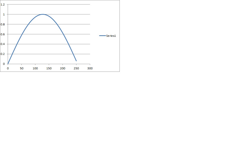

    Default Re: FREQOUT command for continuous operation
    its a half wave samples are sin(pi*(I+10)/256 )*256 where I=1 to 25
