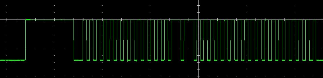

Is it possible to interpret non-standard serial data with PicBasic (sample attached)
Page 1 of 2 12 LastLast
Results 1 to 40 of 61
    Feb 2013
    1,160
    Default Is it possible to interpret non-standard serial data with PicBasic (sample attached)

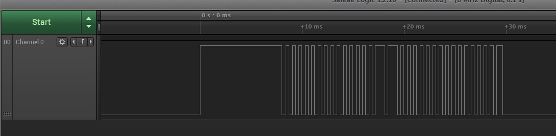

    I have some remotely managed studio strobe, it has keyboard, and when pressing numerical keys, the following sequences being transmitted on single wire, as shown on the picture. What protocol is this, and can I somehow interpret it, using picbasic pro?
    Width of wide pulse is 1.9msec, and width of narrow pulse is 642usec.
    Default Re: Is it possible to interpret non-standard serial data with PicBasic (sample attach
    It looks like some kind of binary coding judging by the number entered and the output stream. Why not ask the manufacture for the protocol?

    hi dave,
    it reminds me of a sort of binary encoding...
    0= no missing pulse 0000
    1= 1 missing pulse in the "ones" position 0001
    2= 1 missing pulse in the "twos" position 0010
    3= ones missing and twos missing 0011
    4= 1 missing pulse in the fours position 0100
    5= ones and fours missing 1001
    it would help to see all the way up to 9
    do you also need to decode other letter/function key/enter/backspace etc. etc. characters??
    I don't recognize the protocol off hand but then I am no protocol expert.
    perhaps some sort of digital logic analyzer that has a good interpreter behind it would help.

    Yes is goes up that way, I can record it up to 9, but you are correct, it looks like plain BCD code, but the rendering of "0" and "1" with pulses, looks weird for me. I have saelae logic analyzer, but it can't detect these pulses at all, I've used scope to record them.
    In fact, I want very simple thing - say, set variable ENABLE=0, when "zero" is transmitted, and ENABLE=1, when any other digit is being sent. I'm not looking for character decoding or whatsoever.
    Feb 2013
    1,160
    I was suggested, that this is PPM (Pulse Position Modulation), used in some IR/RF remotes and telemetric control equipment. Datasheet of Holtek HT6222 shows quite similar, but not exact diagram of signal.

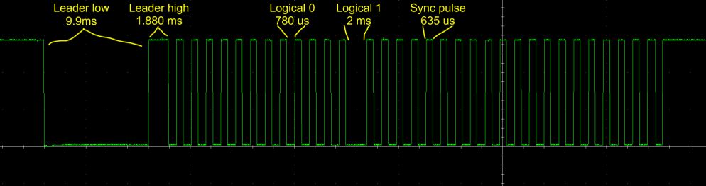

    The system used is IDPPM - Differential Pulse Position Modulation.
    Now I changed algorithm, and it detects pulses, there are 34 pulses, and it does it properly. But quantity of pulses is always 34, only pauses between them change, so COUNT is not proper implementation I guess.

    This, to me, is the classic problem of how to tell (program) your micro controller to recognize and interpret the pattern.
    The human brain combined with an eyeball can recognize it... now you just need to figure out how to translate that into code.
    I would start by watching for the start pulse, which is longer than the other pulses. Then keep track of the width of the following pulses (or the width of the "low" part. Then watch for one or more extended "low" pulses.
    Since you only need to differentiate between 0 and any other number/key press, then just watch for an extended "low" in a given time period after the extended "high" start pulse. If in the given time period you do not get any extended "low" pulses then the digit is "0" other wise if you get an extended "low" pulse then the keypress was non-zero.
    Since the quantity of pulses in each character is always 34 then you should be able to just set up a counter to increment whenever the pulse is low and stop incrementing when the pulse goes back high. Then if the counter has incremented above a certain threshold then that particular "low" pulse was a "wide" one and indicates a non zero digit. (I hope that makes sense)
    I believe it is easily do-able. you just need to distill it down to how to detect the extended low pulse that indicates a non-zero digit pressed.

    Easy! It’s giving you a wider pulse duration at the start to qualify the incoming data.
    From there you only need to sample 32 times at the correct interval.
    So look for that, then read it in with a 32 step loop.

    My oscilloscope can record in .csv format, is it possible in some emulator to "play back" this recording, and feed it to virtual chip? So I can test and debug without using original hardware, which generates these pulses.
    2,720
    the waveform is simple to simulate like this is you have a chip with a dsp module.
    note the timings are estimated since the curious one's info is lacking most of the meaningful detail
    the output

    Wow! Such an input.
    Here are signal details. Actual signal is high and goes low, on my last picture, I've inverted it just for ease of viewing and analyzing.
    On the picture below, I've specified all timings as required.
