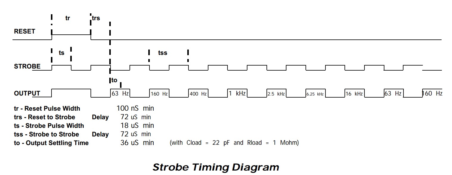

    Hello. I want to build a audio spectrum analyzer using this chip. The picture below is from datasheet:
    Below is the sample code I've created for reading the chip:

    To simplify the things, code above reads only data for 3 frequencies, full code will read 7 frequencies, then repeat in loop. Is above code correct, how do you think?
    Default Re: Timing diagram for MSGEQ7 spectrum analyzer chip, is it correct?
    As usual, have YOU tried it yourself?
    Random comments:
    * Don't use HIGH/LOW, they're wasting time and program space.
    * After STROBE goes LOW (active) there's a 36us (minimum) settling time so I'd wait that amount of time before sampling the output.
    * The ADCIN statement is likely to take longer than the needed 18us so there shouldn't be a need to have that delay in there.
    * What's being done in the display subroutine? Does it take longer than 18us? If so move things around and eliminate the other delay as well
    FOR Band = 0 to 6
      STROBE = 0
      PAUSEUS 36   ' Wait specified settling time
      ADCIN 1, Value   ' Take a reading, this will take tens of uS depending on how the ADC is setup.
      STROBE = 1
      GOSUB Display  ' This will also take time so we'll most likely meet the 72us minimum strobe to strobe time - needs verifying.
    NEXT
    Or, sample all bands and then display them
    Spectrum VAR BYTE[7]
    Band VAR BYTE
    FOR Band = 0 to 6
      STROBE = 0
      ADCIN 1, Spectrum[Band]
      STROBE = 1
      PAUSEUS 36   ' Can probably be removed altogether since ADCIN will provide the needed "delay".
    NEXT
    The above has obviously not been tested, it's being provided as food for thought.
    Attachment 8263
    'INIT
    HIGH RESET
    HIGH STROBE
    PAUSEUS 18
    LOW STROBE
    PAUSEUS 18
    LOW RESET
    HIGH STROBE
    PAUSEUS 18
    'READING
    LOW STROBE
    ADCIN 1, VALUE
    BAND=1
    GOSUB DISPLAY
    PAUSEUS 18
    HIGH STROBE
    PAUSEUS 18
    LOW STROBE
    ADCIN 1, VALUE
    BAND=2
    GOSUB DISPLAY
    PAUSEUS 18
    HIGH STROBE
    PAUSEUS 18
    LOW STROBE
    ADCIN 1, VALUE
    BAND=3
    GOSUB DISPLAY
    PAUSEUS 18
    HIGH STROBE
    PAUSEUS 18
    Just thought i'd mention you're using 18uSecs for your strobe pulses....
    Looking at the diagram, 18uS is the MINIMUM duration, so you're right on the edge of it not strobing, or being intermittent about strobing the chip or not.
    I'd be inclined to make your strobes 20,25 or even 30uSecs duration to be certain it'll trigger the chip consistently.
    Just my 2cents ;-)

    So, my general idea is correct, and I can go on with hardware?

    From the datasheet the times stated are for the minimum times, therefore I went with 100uS not 18uS, also I used a FOR NEXT loop to keep the code short. I am using an 18F252 to read from the ADC and outputting onto a standard LCD, using two arrays of seven each in the code variables for the code setup:
