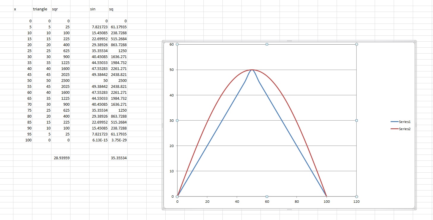

    power is whats being measured here
    power = V squared / R
    the effective power is the sum of the instantaneous powers measured in your wave form, try it for a triangular wave
    R=1 ohm Vp=50 , Vave=25v Vrms=28.8
