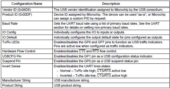

    Am I missing anything?
    Simple answer, yes.
    The MCP2200 is a preprogrammed PIC, which appears to the world as a USB to Serial convertor. Ading a mouse descriptor and the necesary software to service the descriptor is essentially impossible (no flames please). You would be much better of starting with a 18F14K50, modifying a HID sample.
    The data sheet gives details of how to change it's PID (among other things). From the data sheet -
    The configuration utility provided by Microchip allows the user to configure the MCP2200 to custom defaults. The configuration utility (shown in Figure 2-1) connects
    to the device’s HID interface, where all of the configurable features can be set.
    .I don't want to use the onboard USB as it doesn't have a vendor id
    Incorrect. The VID and PID are changed in the descriptor file which will be part of the compiled project.
    eg The portion of gen_desc.bas which defines the VID (among other things), in this case 04D8 hex.
