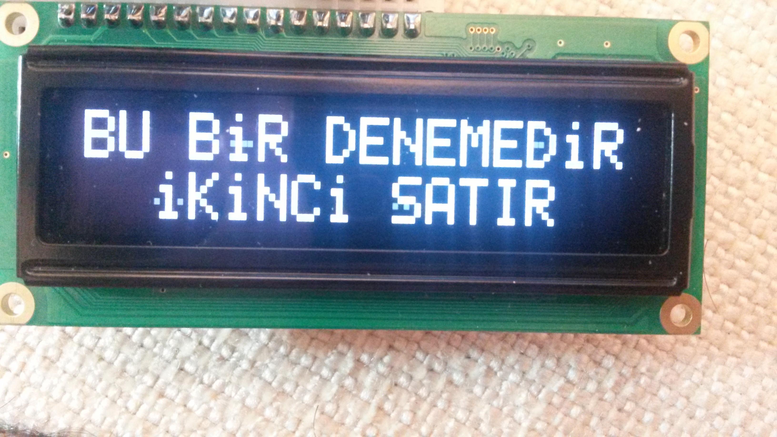

    Hello everyone ;
    I've been working on a project which requires an LCD display then I decided to get an oled in order to free some pins also to ease the PCB design
    and I purchased an OLED code named EA W162-XBLW (ICEWHITE) of Electronic Assembly but I have a disturbing problem with the LCD .. After I power the circuit up I can perfectly display all the characters on whereever I want on the lcd but there is an incredible noise moving all around the LCD in a form of a pixel , So far I have tried using capacitors even those larger ones and even added the define LCD command and data line parameters with several tries ,, but no lock so far .. Here I share the code and a picture ... I hope any of you had such a weird problem in the past and solved it ...
    The code is for 16F1827
    #config
     __CONFIG _CONFIG1, _FOSC_INTOSC & _WDTE_OFF & _PWRTE_ON & _MCLRE_OFF & _CP_OFF & _CPD_OFF & _BOREN_OFF & _CLKOUTEN_OFF & _IESO_OFF & _FCMEN_OFF
     __CONFIG _CONFIG2, _WRT_OFF & _PLLEN_OFF & _STVREN_OFF & _BORV_19 & _LVP_OFF
    define OSC 4
    OSCCON=%01101010    'OSC is @ 4 MHZ
    '------------- LCD DEFINES ------------------------
    DEFINE LCD_DREG PORTB 'LCD data port
    DEFINE LCD_DBIT 4 'LCD data starting bit 0 or 4
    DEFINE LCD_RSREG PORTA 'LCD register select port
    DEFINE LCD_RSBIT 7 'LCD register select bit
    DEFINE LCD_RWREG PORTA   ' LCD read/write port
    DEFINE LCD_RWBIT 0   ' LCD read/write pin bit
    DEFINE LCD_EREG PORTA 'LCD enable port
    DEFINE LCD_EBIT 6 'LCD enable bit
    DEFINE LCD_BITS 4 'LCD bus size 4 or 8
    DEFINE LCD_LINES 2 'Number lines on LCD
    '------------- LCD DEFINES -------------------------
    PORTA=%00000000     :      PORTB=%00000000
    TRISA=%00000000     :      TRISB=%00000000
    'ADCON0=%00000001    :      ADCON1=%10110000
    ANSELA=%00000       :      ANSELB=%00000000
    'OPTION_REG.7=0
    lcdout $FE,$28
    lcdout $FE,$17
    lcdout $FE,$06
    lcdout $FE,$08
    lcdout $FE,$01
    lcdout $FE,$02
    lcdout $FE,$0C
    MAIN:
    lcdout $FE,$80,"BU BiR DENEMEDiR"
    LCDOUT $FE,$C0,"  iKiNCi SATIR  "

    Default Re: OLED Display Noise problem
    I would suggest writing to the LCD only when you need to update the display info.
    Constantly writing to it in a loop without any kind of delay may be causing the problem.

    Thanks for your response .But what if I need to display some sort of ADC reading which requires an instant update on the lcd continuously ?? You know how fast those readings may change ...

    You can only "see" so fast before it becomes a blur.
    Try adding a PAUSE 33 in your main loop as it is, making it 30fps, just to test if the ghost dots go away.
    Tried but still no luck
    Have you got your decoupling capacitors on board?

    Yes I have tried a several values of capacitors even those large capacitors around 470uf and smaller ones and also together but it doesn't help ..
    Try something like this
    lcdout $FE,$28
    lcdout $FE,$17
    lcdout $FE,$06
    lcdout $FE,$08
    lcdout $FE,$01
    lcdout $FE,$02
    lcdout $FE,$0C
    GOTO Main
    And remove everything from board except power supply, PIC and LCD. Add 10uF, 100nF, 10nF capacitors to LCD power pins, preferably use SMD.
    If problem still persist then problem is in LCD. Or it can be "dirty" power supply. You didn't post schematic, so...
    You said that you need to display data as fast as possible. If that is really what you need, then use 7 segment led display. And you can get 3-4K FPS, but then you need super human to read that.
    If only regular humans will read display then more then 4 or 5 updates is more then enough.

    I tried adding pause 100 command right after the lcdout commands but the noise only got lowered just a little .. This is definitely not normal .. But when I apply 1000 ms of delay it almost stops making noise on the screen(there is still a little) ... But It musn't be that bad .. It is an oled and the datasheet claims parameters for write/read around nanosecs .. Where do I do the mistake ? , May it have anything to do with the LCD or a defective circuit component ... On the other hand I think It musn't have because It can display chars succesfully with a huge amount of delay periods ...

    It is not a regular eye read actually I am planning to make a vumeter to read that's why I need that fast readings ...

    That sound to me as bad PCB design and/or power supply. But sill could be bad LCD driver.
    If long delays make artifact disappear, then capacitive coupling between LCD signals and power lines can cause that.
    You can try test that. Add pull down resistor 1K to LCD Enable pin, and create easy way to disconnect LCD and resistor from PIC, as close as possible to LCD.

    Display shouldn't update any more. If you see dots then 99% problem is with PCB layout, and decoupling.
    If there is no dots on LCD then problem is with LCD.

    Well ;
    I did exactly as you asked me to do and as you say it's got to do with the lcd then ...

    I don't have the same chip, but used an 18F4580 with a 2 x 16 LCD and just changed the lines to run the LCD from port B to suit the EasyPIC5 development board and I don't get any strange random pixels and I'm running the chip at 20Mhz so the switching is much faster, so it would suggest that it is your hardware that is at fault.

    Replaced the 20Mhz with a 4Mhz xtal and recoded and the display was fine.
    What can I say .. I am so unlucky with these OLEDs .. But thanks for your effort anyway ..
    - Ipsa scientia potestas est -

    Today a new EA OLED display has arrived yet the same problem still occurs ... There might be a picbasic incompatibility with the lcd because my connections are exactly the same with the code I shared , nothing more nothing less ..

    Thanks for your great effort but now it doesn't show anything on the display ..
    Feb 2013
    1,170
    It is not bug, it is feature
    These oled displays are so fast, so you're seeing the cursor moving
    Dec 2012
    Türkiye
    103
    So any clue how to turn off this moving cursor .. Besides these moving cursor must be moving only at the first line of each character yet I see this noise on all over the screen ..

    I recall most LCD's have a "cursor off" command? (i believe the OLED replacements for LCD's should also have cursor-off too).
    Turn the cursor off at the beginning of your code, just after the LCD initialises. If you ever need to see the cursor as a prompt, then re-enable the cursor during that part of the code only.
    hope this might help?

    Look at page 4 of datasheet
    Display On/Off Control 0 0 0 0 0 0 1 D C B Sets entire Display (D) ON/OFF. Sets Cursor (C) ON/OFF. Sets Blinking (B) of Cursor Position Character.
