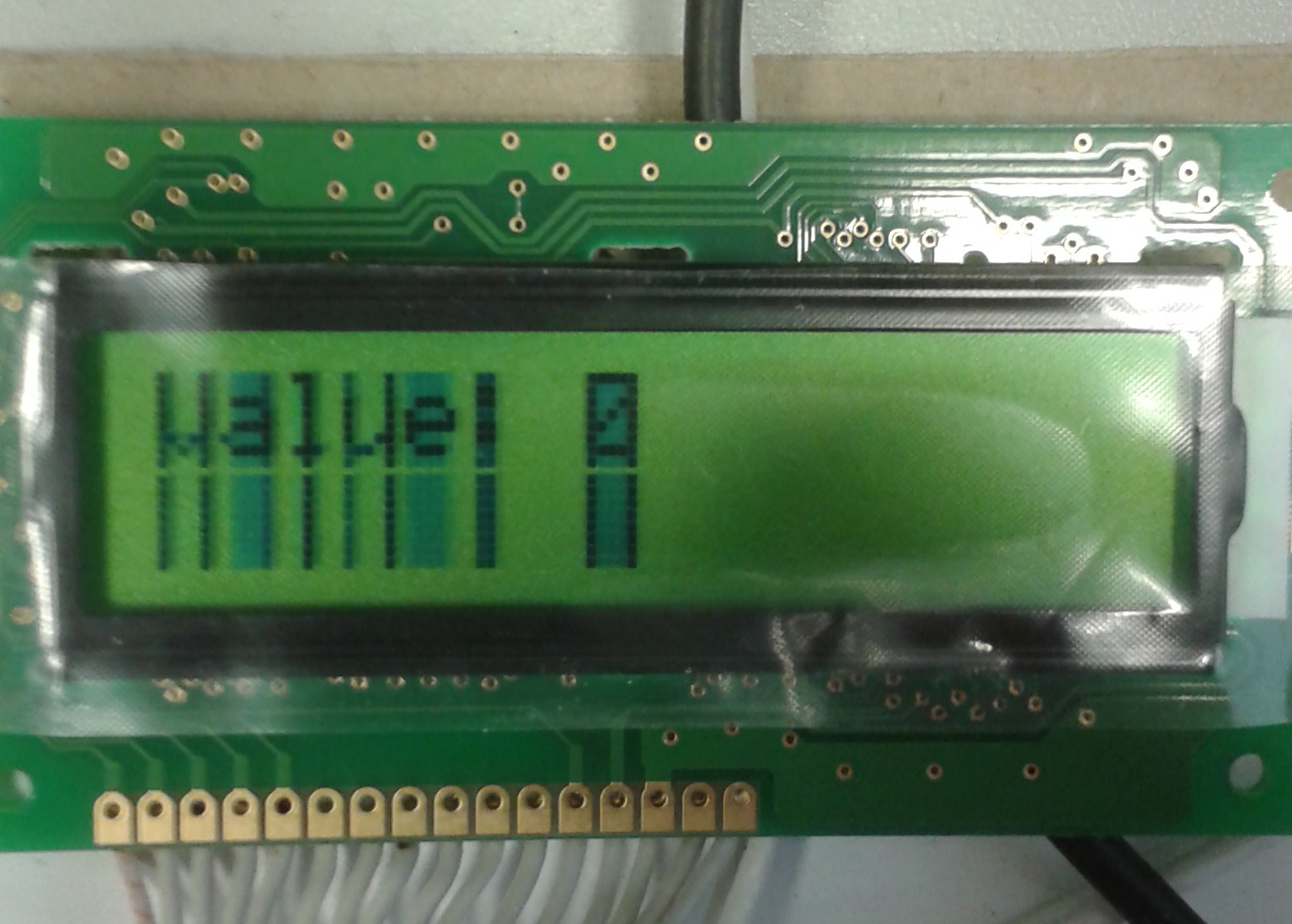

    I atached photo of my wrong LCD. I do not know, what is the problem with LCD.
    Display is marked as MC10621E8-SYL, *W 4034
    But after changing, everything is OK.

    Thanks for posting the picture. So to me the picture says a lot... It definitely shows a problem with the LCD but it also shows that your code is working, more or less.
    I would submit that if others that posted comments about checking your register settings and AD setup would have known your display looked like that they would have suggested a problem with the LCD before talking about your code setup.
    It's obvious that you were smart enough to recognize that there was an issue with the LCD and you replaced the defective display.
