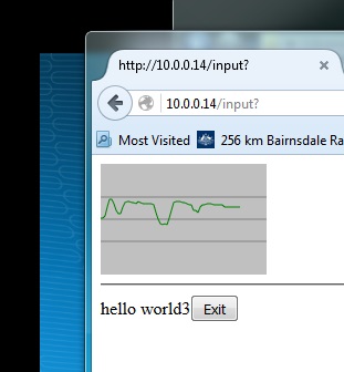

    this little app shows my solar panel output for the last hour , samples at 60 sec interval
    grey lines are at 16 14 12 volts [can't figure how to add text labels to graphics yet
    prescaled sample input from pic
    g6868645855556165666665656466656464646464635650464 54645515865666666656564636358585661636364646463636 363636161616161616161
    each sample is a two digit decimal scaled to suit the graph ( sample * 10) - 140 + 50
    graph y range = 100 points , mid point of display is 14 volts so y range is 9 to 19 v with 0.1 v resolution
    if sample = 15.8 volts then graph_sample = 158 - 140 + 50 = 68
    graphic refreshes every 15 sec and the pic feeds in fresh data every new sample (60 sec)
