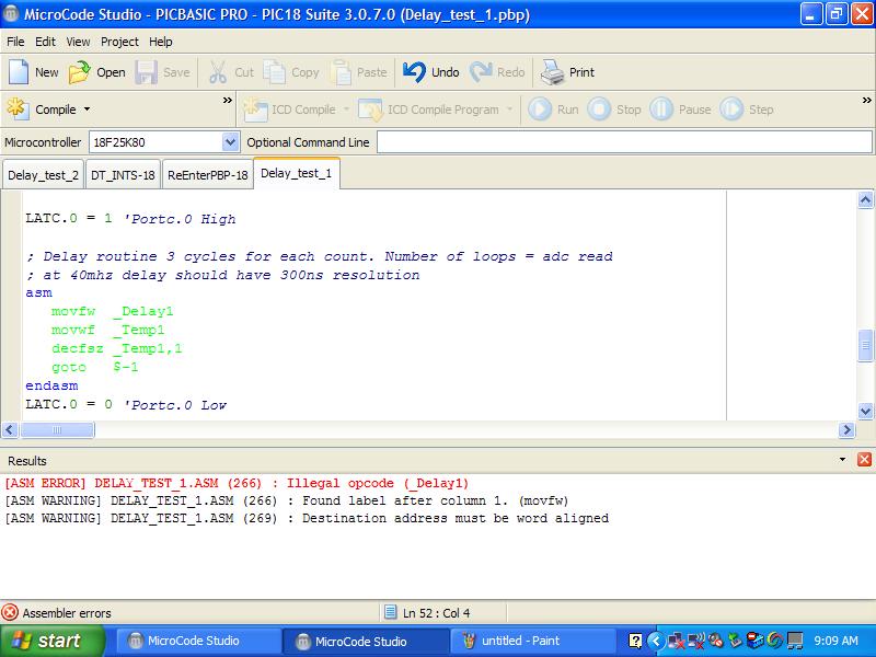

    I am trying to get an adjustable delay routine that is less than 1us increaments i.e (pauseus). I use to program in assembly and had a working delay routine. It took three machine cycles to decrement the counter by one. Using
    a 40mhz it should have a 300ns resolution. It is adjustable by taking a adc reading in pbp and passing the variable to the inline assembly routine. When I compile it in PBP3 it produces some errors. Using a PIC18F25K80. If anyone knows why it won't compile or has an alternate idea, I would be greatful.
    Mark
    See screen capture of error messages

    Hi Mark,
    I'm really bad at assembly language but as far as I can see from the instruction set summary in the datasheet there is no MOVFW instruction.
    The Destination adress must be Word aligned-warning is probably because on the 18F series the program counter adresses bytes while the instructions are WORDS so you need jump in increments of 2.
    Finally, your variables are WORDs but I'm not sure you're catering for that in your assemble routine but then again, I'm really bad at it so perhaps you are.

    Delay1 var word
    Temp1 var word
    movfw _Delay1
    movwf _Tem p1
    decfsz _Temp1,1
    goto $-1
    Endasm
    IT'S a 8 bit cpu how can a 16 bit value fit in a 8 bit register ?
    Delay1 var byte
    Temp1  var byte
    asm
           MOVE?BB   _Delay1, _Temp1
    DLN    decfsz _Temp1,1
           goto   DLN
    endasm

    Thanks Henrik,
    On your first point, I'll restudy the data sheet for the proper command. I might of reversed the WF when entering the code.
    Second point makes sense also. The asm delay routine was being used for pic16f's and worked. I have run into the count by two
    before on pic18's. So I know what you mean. Still interested in alternative.

    Thanks Richard,
    I will give it a try. It's been a long time since I used the code, and It probably was a byte variable.
    It compiles fine here. I will try it on hardware later.

    It’s crying because there’s no such movfw instruction, only movf.
