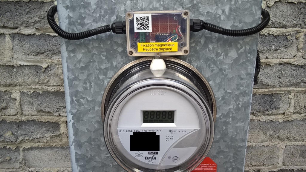

    Hi group!
    I just want to show you my latest project made with PicBASIC: Wireless Wood Stove Monitor
    This project will be part of a bigger project and here is a clue just for you PicBASIC community:
    https://thingspeak.com/channels/20713
