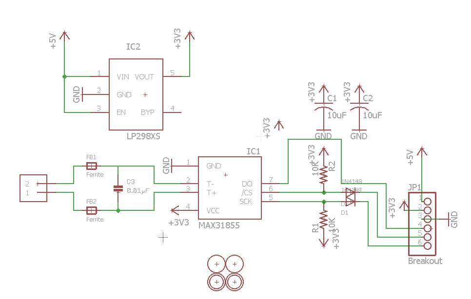

    Check out at Adafruit's breakout board. They have a nice solution: https://github.com/adafruit/Adafruit...breakout-board
    Why not powering your PIC with 3.3V? That saves a lot of trouble.

    Rather than buying expensive chips why not make your own with this app note:
    The Adafruit board is quite pricey but look how they did the level shifting. I did use this trick with an ESP8266, worked fine.
