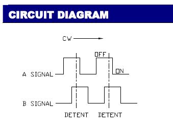

    That really depends on the encoder. Most I've seen (if we're talking about the ones used to replace a pot and knob) are quadrature output and even those come in different flavours. Some have one detent per qudrature cycle, some have four detents per qudrature cycle and some doesn't have any detents.
    Here's an example I already had in my attachments on the forum. This specific encoder has a full cycle per detent.
    Name:  Encoder output.JPG
    Default Re: Using an incremental rotary encoder?
    I think I've got it now. I'm not really using a command statement like PULSIN. I'm simply checking the state of the two pins connected to the encoder and I can use the XOR operator to interpret the Gray code as moving CW or CCW. Does that sound about right?
