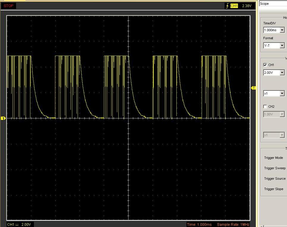

    And the attached picture is what the scope shows (not an expensive scope by ANY means). My question is after the image.
    Any idea what that slope is as the port is switched from output to input? Any way to get rid of it? Or am I just on the wrong track here?
    Andy

    Does it happen with x10 attenuation probes and setting on the scope?
    If the chip is doing nothing else, is it any better switching the whole port?
    TRISC = $00
    TRISC = $FF

    [QUOTE=Art;135608]Does it happen with x10 attenuation probes and setting on the scope?
    Yes. Here is the image:
    I also had the thought that I did not have a decoupling capacitor on Vdd - no difference. I also tried hooking a regular LED up to the port as I only had the scope hooked up to the port before. No difference.

    You'll notice, I tried switching the whole port - no joy. This is getting frustrating, any other ideas?
    *Update* I had the bright idea that, maybe, if I turned a MOSFET on and off with another port and used the MOSFET to switch the pwm signal on and off, it would get better. Not really, its about the same, but as the MOSFET turns off, that slope has the pwm signal messing it up. So its worse. Back to the way it was - I guess I'll have to try it. Of course, I can't try it until after Christmas......
    Andy

    Wow! You are SO right - looks MUCH better now. Thanks!
    Still has that slope on it though. I might try DT's Instant Interrupts and use a pin on and off to get it. Here's what the code is now:

    would a pull down resistor (say 1k) make the trace look better

    Well, the scope has measurement functions. Again, this is NOT an expensive scope ($75), but it was reporting 38.46KHz and 26uS period......both right in the ballpark of what I was looking for.
    And that was the answer! See my last post for images.
    Thank you!!

    The answer was a pull down resistor. It got rid of that slope. I tried a few, and worked out that 4.7K was the highest value I could use. That gave me a final voltage about 4.2V which should be fine.
    Then I had to play with the frequency I specified to get exactly 38 pulses in 1mS. Even though the scope's measurement function still reports it as 38.46KHz - I told you it was a cheap scope!
