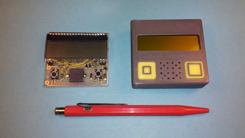

    Hi All,
    I've finished a cooking-timer (or kitchen-timer, as you like...) program and circuit.
    I made two prototypes up to now; the first equipped with a Xtal and the second with a resonator.
    Unfortunately, both circuits are "slow" in timing. After 1 hour internet time reference, the timer has still 24 to 25 seconds to go before its countdown is finished.
    I changed Xtal and capacitors (15pF), tried a ceramic resonator but nothing does.
    BTW, my circuit is using Melanie NEWMAN's "Olympic Timer".
    How can I tune things without having to bit bang the timer interrupt routine?

    Roger
    SWITZERLAND (french speaking)
    938
    Default OSCTUNE register
    ...well, I just tried to roughly adjust the oscillator's settings via the OSCTUNE register and it looks to make some effect.
    Until now, I was assuming OSCTUNE was only effective while using the internal oscillator.
    Am I wrong?
    Roger
    938
    Default Re: OSCTUNE register
    No, something else is affecting the oscillator's accuracy. But what is it?
    I can't see "real" changes by setting the OSCTUNE register. Still believe it doesn't work when using an external oscillator.
    Roger
    On Interrupt Goto TICK_INT
    How many times an Hour ???
    938
    Wow, good notice about the calibration code! ;-)
    Going back to my desk and count the ticks in one hour...
    Merci Alain
