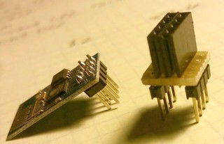

    Since the pin spacing does not fit a typical breadboard you may need to buy or build one of these...

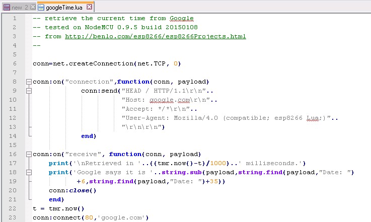

    Here is one way of getting time using the NODEMCU OS and Lua code...
