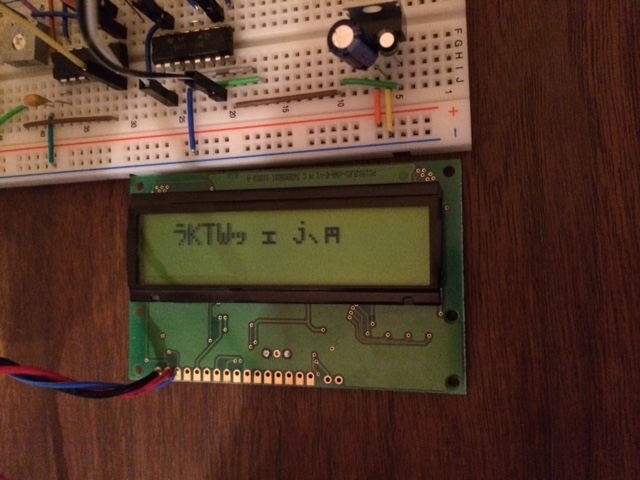

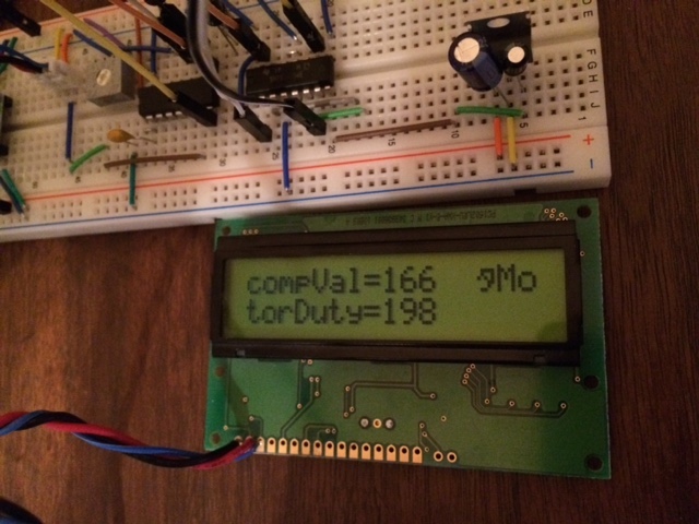

    Here's the annoying part - no matter how many searches I do here I can't find the syntax to print on the 2nd line of the LCD. With the above the screen just seems to flicker (which also doesn't make sense - with the ADC method here it usually results in a rock-solid value; in other words, it doesn't change until I actually move the wiper arm. I know it's unrelated to the original post, but any ideas?
    Default Re: Scaling ADC Result to a Set Range
    Think of the ** operator as multiplying by units of 1/65536. 0.6*65536=39322.
    As for printing to second line of the LCD you're obviously using some sort of serial interface display(?) which I know nothing about but if I'd make a guess based on your defined constants you'd do something like
    HSEROUT[LCD_INST, LCD_L2, "2d Line"]
    Thanks Henrik. You'd think I would have noticed that constant. Changing the HSEROUT to this:

    I can now see the 2nd line, but it's not starting at the first character position and there's a weird character there before 'MotorDuty'. It might be related to the spaces after the first line, but I'm not sure. Also, the first line seems to be refreshing/fluttering even when I'm not moving the trim pot. I have to admit, I use my serial LCD so infrequently that I'm a noobie where it comes to this.

    I used the HSEROUT line exactly as above and when I turn on the power:
    Then, as I turn the trim pot wiper:
    The serial LCD is 2400 baud by default and that's what I have set in code, but maybe there's some timing issues?

    either setting will work the 0% error eusart option is probably best ,
    if you set the baudrate regs manually ie
    DEFINE HSER_SPBRG 130 ' 2400 Baud @ 16MHz, 0.0%/SPBRGH = 6
    or
    DEFINE HSER_SPBRG 103 ' 2400 Baud @ 16MHz, 0.17%
    then DEFINE HSER_BAUD should not be used ,it may cause your setting to be overwritten
    ps
    baudrate error is not your display problem, you need to find out
    1. how to initialise your display and how long it takes to happen
    2. how to send control codes to the display ( seems $fe is not correct)
    do you have any docs for the display / or a model no ?

    I switched to using the EUSART DEFINEs & register settings (commenting out the original ones) and it seems better (no initial wonky characters) but the 2nd line still isn't going to the 2nd line. Maybe if I split out the instruction for the 2nd line with a 5 ms pause?
    Here's the data sheet for my serial LCD.
    From Data sheet
    Smart Linefeed (control-J, ASCII 10)
    Move cursor down one line. If immediately preceded by carriage return, linefeed is ignored
    Try it without the 13, see what happens. Or try it with only 13 (more likely)
    Failing that, if your message never changes, add spaces between " and MOTOR

    none of these are correct
    #IFDEF USE_LCD_FOR_DEBUG
    LCD_INST CON 254 ' instruction
    LCD_CLR CON 1 ' Clear screen
    LCD_L1 CON 128 ' LCD line 1
    LCD_L2 CON 192 ' LCD line 2
    #ENDIF
    LCD_CLR CON 12 ' Clear screen
    LCD_HOME CON 1 ' HOME
    LCD_NEXT_LINE CON 13 ' CR does this go back to line 1 when current line is line2 ? seems it will go to first pos of line
    LINE 2
    WOULD BE HSEROUT [16,80] to be sure
    TRY
    HSEROUT [1,"ADCInVal=", DEC ADCInVal, " ", 13, "MotorDuty=", DEC MotorDuty, " "]
    or
    HSEROUT [1,"ADCInVal=", DEC ADCInVal, " ", 16,80, "MotorDuty=", DEC MotorDuty, " "]
    ps the display needs 1000ms delay to power on/boot before you try to write to it
    LINE 2
    TRY
    or
    What makes you think they're not correct? The clear screen command has worked just fine all along. Nonetheless, I will try what you suggest.

    Thanks to all your help, the screen is finally working. In case anyone is interested, here's the working code:
