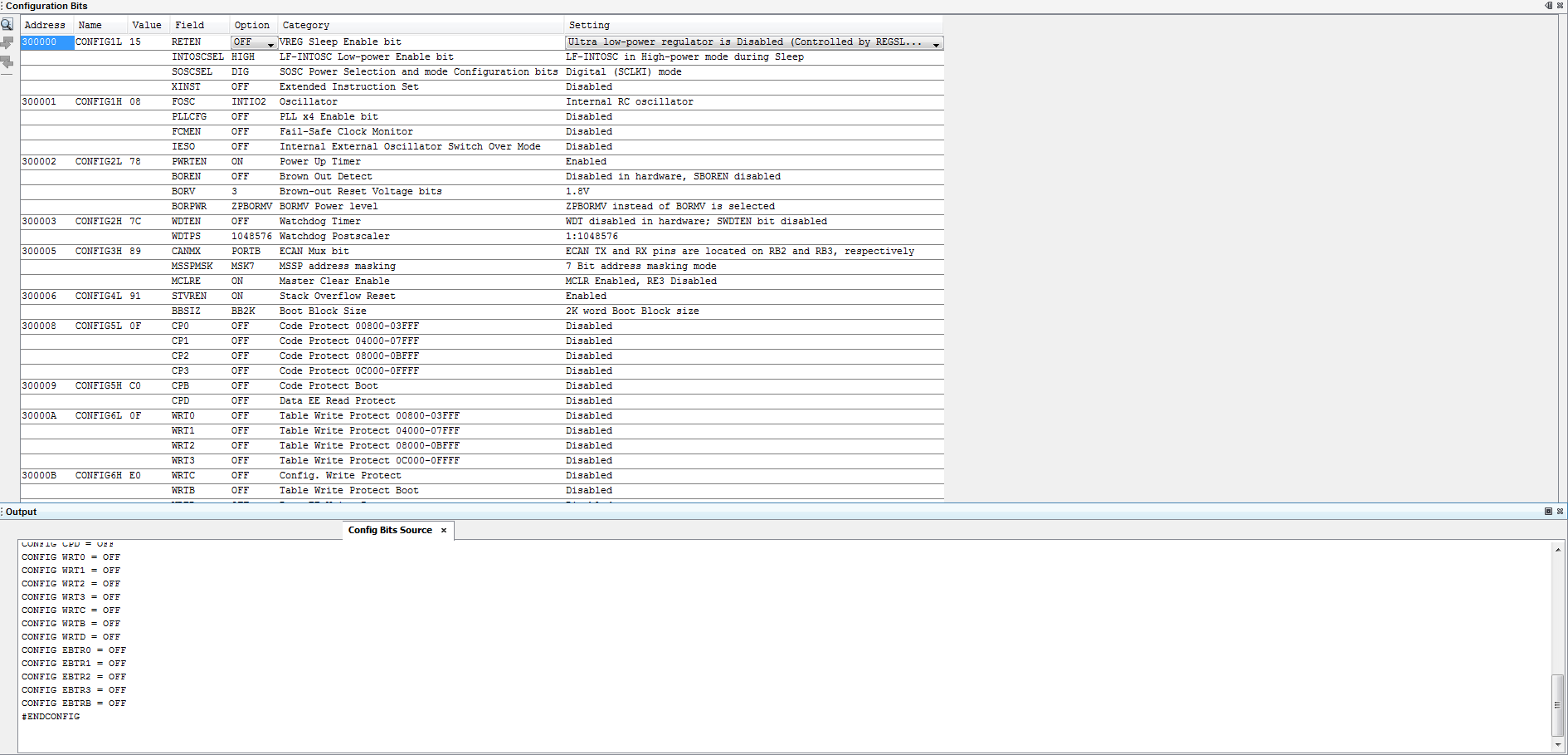

    MPLAB X have fuse configurator buil in.
    MPLAB X>Window>PIC Memory Views>Configuration Bits:
    http://www.picbasic.co.uk/forum/atta...9&d=1391798898

    Wow!
    I had tried MPLAB a long time ago but had been turned off by the interface. It just didn't seem as easy to get going (for a beginner) as MicroCode Studio Plus.
    It looks like I'm going to have to give it another try after all. And it's free too. I went through the user guide and didn't see any reference if there is a retriction to what compiler it supports.
    Dumb question #34: Does PBP v2.60c work on MPLAB X?

    I don't see any mention so far that MPLAB X is for PBP 3.0 only, or am I missing something? I thought I had seen that restriction last year but now I can't see it (probably right in my face too).
    If MPLAB X supports v2.60c, I'm not interested in reinventing the wheel. Somehow I have a feeling it doesn't, just because of the new way CONFIGs are handled.
    Default Re: Configurator
    I use MPLABX with PBP2.6
