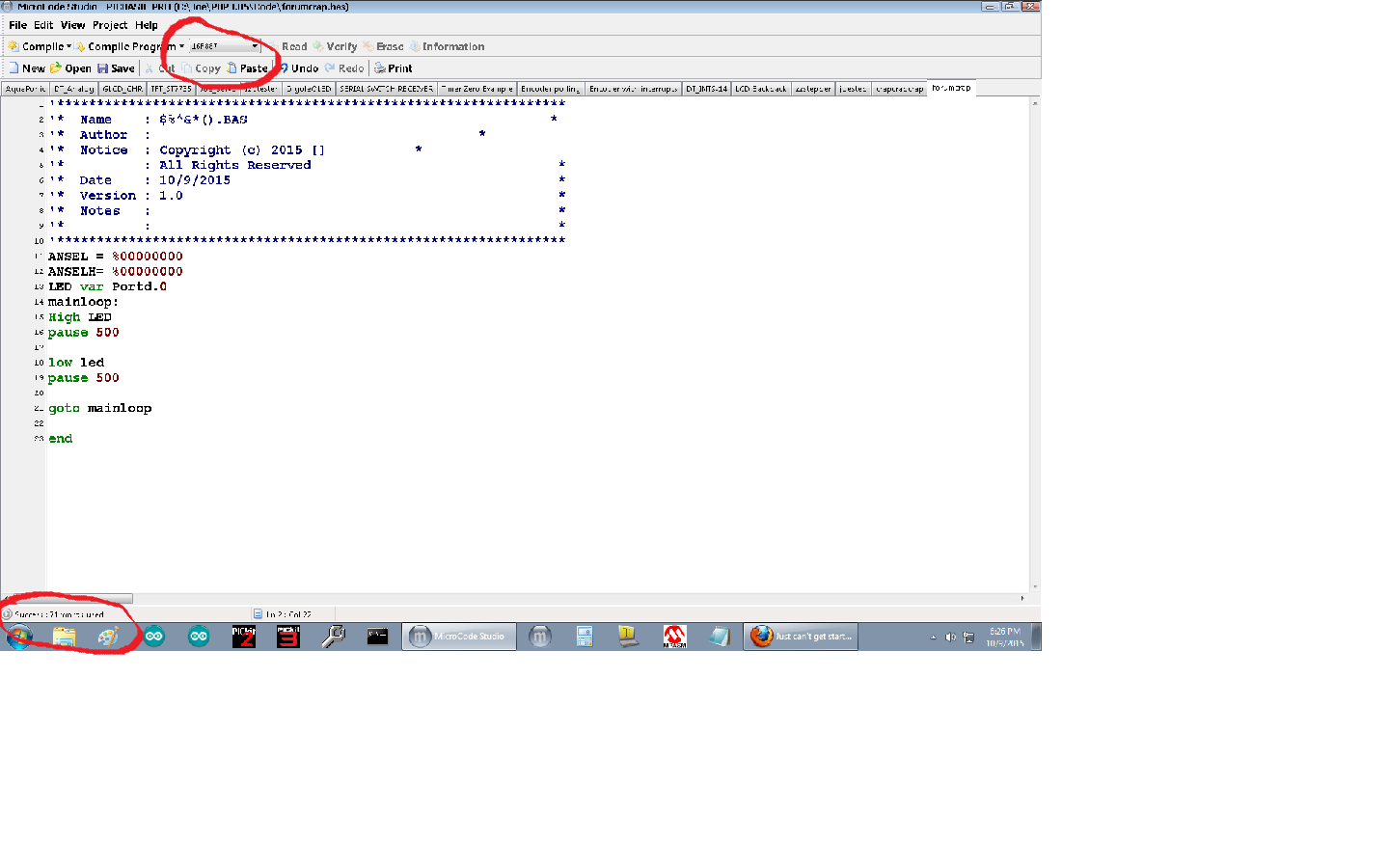

Size:  70.5 KBName:  sucess.png
    Sorry I copy pasted your code, see the image. Now if you select a chip WITHOUT ansel you will error out.
