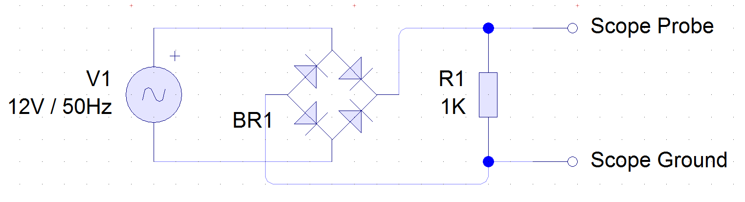

    Hi, I have a very simple circuit setup to detect AC zero crossing. There's a mains AC transformer (230 to 12V) which connects into a full wave rectifier. There are no other components.
    When I measure the raw AC out of the transformer with a scope I see a nice sine wave as expected. When I measure after the rectifier I see what almost looks like DC ripple but with every 2nd trough cut off. (screenshot attached)
    Has anyone see this before and does anyone know what's causing it?

    Do you have some kind of load?
    Jun 2007
    Mansfield, UK
    697
    Default Re: Strange DC ripple
    Nope. There's no load. Could that be the problem?

    Yes I think. Try with something like 1k ohm. Probably the capacitance of the junction or some other esoteric phenomenon.

    I have seen that before , I was due to the ground reference for the scope not being the same as for the rectified waveform

    I've tried connecting a resistor as the load but it didn't have any effect.
    I've actually got 2 circuits. The one described in the initial post is a test circuit to try to isolate a problem I was seeing in the full circuit. The scope ground is connected to the negative side of the rectifier output in both circuits.
    The full circuit has 2 resistors used as a voltage divider between the rectifier output and a PIC chip. It also uses 6 diodes for the rectifier to ensure the rest of the circuit doesn't affect the zero crossing detection.
    The PIC chip is also only seeing half of the zero crossings (which is what prompted testing with a scope).

    My original thought was that the capacitor was causing the strange waveform so I setup the test circuit which has only 4 diodes (full wave rectifier) and now a resistor for load. There's no capacitor or regulator attached.

    I specifically used 2 extra diodes to avoid any of the capacitance problems I'd have had using the same positive that supplies the regulator. In theory the main part of the circuit shouldn't interfere with the zero crossing part (not that much anyway).
    The schematic I posted above is just a guide for what my circuit looks like. The scope readings were all taken from the test circuit which I've attached below. There's nothing that should interfere with it at all. This test circuit doesn't have any capacitors or regulators or anything, just diodes and now a resistor.

    Just a couple of thoughts:
    Do you get the same waveform when AC coupled as DC coupled?
    How about changing channels on you scope. Same waveform?
    How about trying a different probe?
    It's doubling frequency so it appears the all your rectifiers are working but maybe change the location of two and see if waveform changes. Could be a bad one or two rectifier.

    cro1 as per test circuit
    cro2 as per test circuit with diode in series with cro ground
    looks the sams as per post 1
