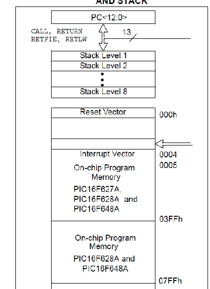

    Hi. Thnx for the welcoming and the quick response. Yes i do have the right mcu selected in my compiler. Can it be that the programme is too large? Should i use maybe a 16f886? Like i said, im new with no experience at all and im willing to learn. Thanx in advance.
    Default Re: failure at 077f
    The picture I posted above is from the data sheet showing the memory map of that series of chips, and indicating that 16F627 has NO MEMORY beyond 03FFh . That is why I submitted my response. If you have a 16F648 or 628 I would bet the hex would go in. Perhaps your programmer is set to one of those chips? The 16F648 has Twice the program memory of the 16F627 and otherwise mostly the same. As you have posted NO CODE I / we are unable to diagnose your problem further. PBP usually complains at compile time if you write more code than the chip will accept.

    Thanx for the response once again.
    A friend of mine is going to the city tomorrow and i'll get him to buy me a 648 which i'll try out with the same code.
    If the problem persist, which i doubt, ill come back and post the code and all. I do believe though that you've solved my problem. Thanx in advance.
